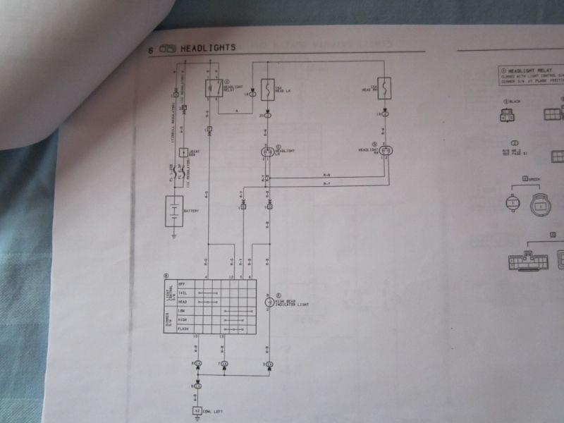

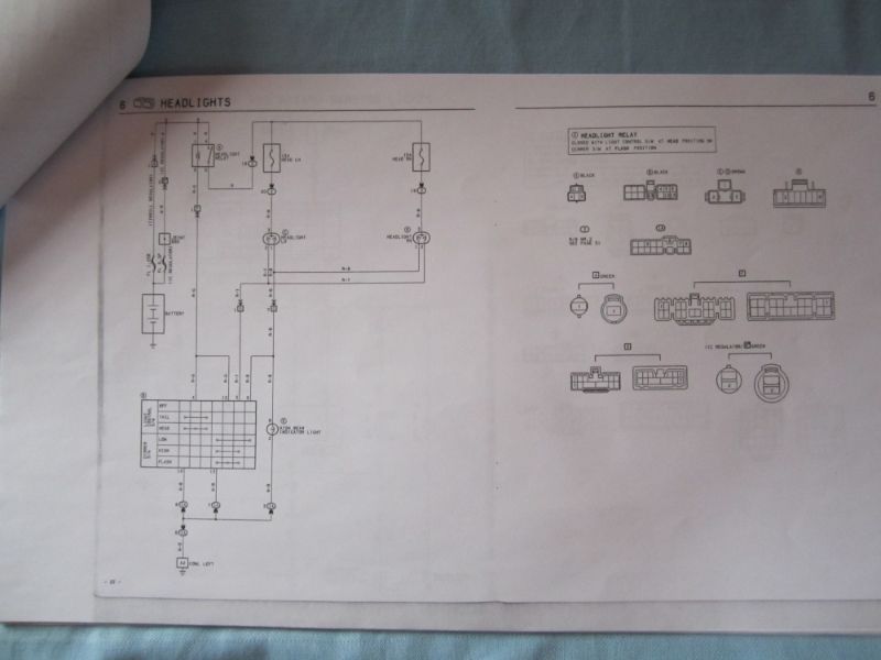

Any way to download a schematic diagram of the 84, pertaining to the headlights? And BTW, THANX FOLKS

These are pictures from a factory manual for a 1986 tercel. They should be identical, except possibly a different colour wire but in the same location.
Hope this helps.
