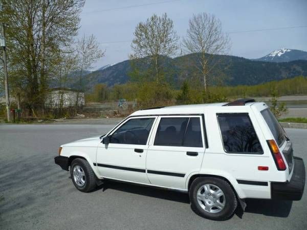

this conversation has come up here at least once before, and i just stumbled across this pic that appears to show a terc with a rear spoiler from a corolla all trac. i think it looks great. i wonder how it was mounted. the pic is just from a 'wanted - tercel' ad so there is no info on it.

That's a mint Terc, the spoiler gives it a sporty look.

Yup, that looks good. I also wonder how it was mounted.

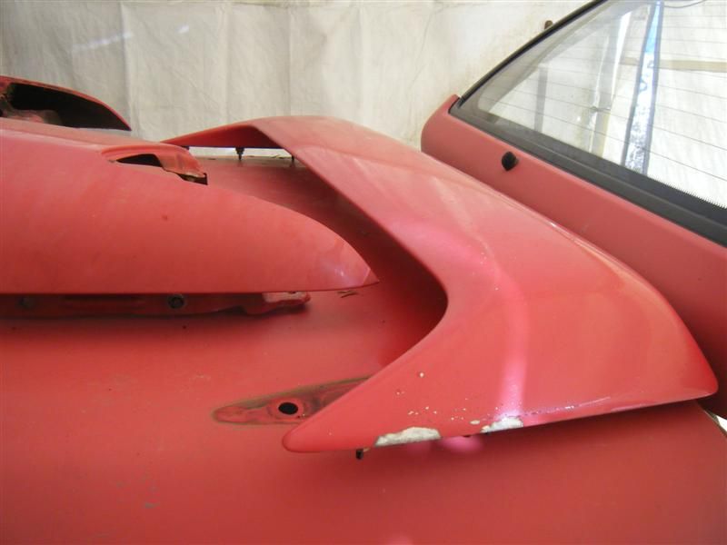

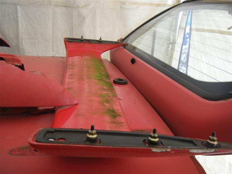

just learned how this is mounted. the all trac spoiler has 3 studs pointing down on each side. they are fastened to the body with nuts which are accessed by removing the rear speaker trim of the all trac. it would be more work to attach it to a terc since they don't have such easy access to the metal roof but it still would not be too much work.
here are some pics of the spoiler i just removed from my all trac parts car.
