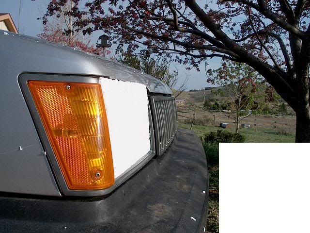

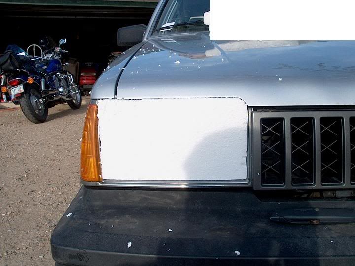

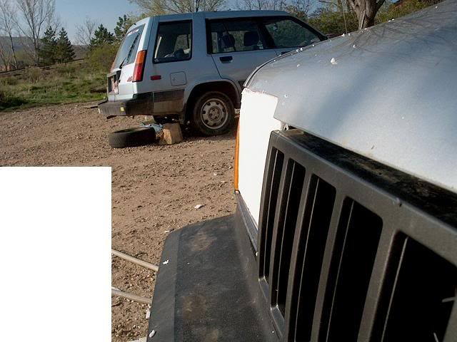

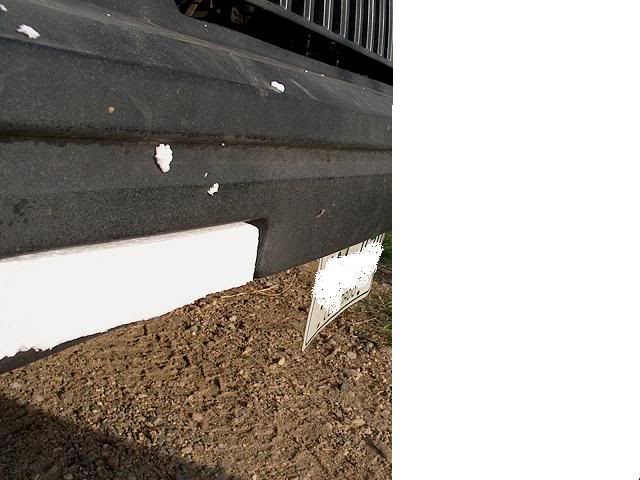

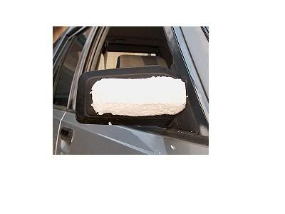

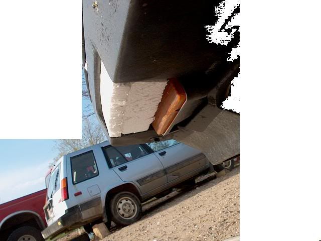

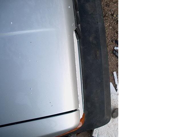

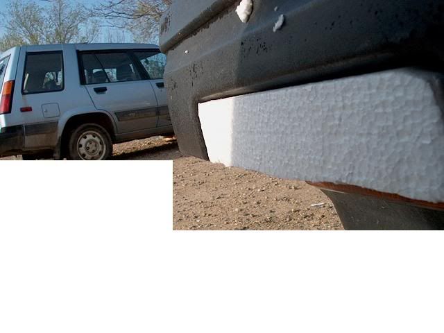

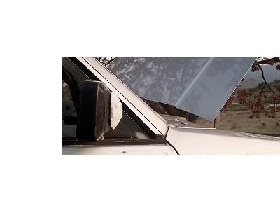

Ok, I have no idea what the wriggity thing is for.... Ummmm.... Yeah..
Those are just a few of the photos I took of stock HORRIBLE aerodynamic places. I have many more, just have yet to host them.
Now the mods (In Styro-Vision!!) That could be done to remove the air "scoops" that are all-too-common in the design.
If we could make less flat spots and "scoops" for the air, we could get much better fuel economy and top speeds!

I would say that the best things a person could do is lower the car by about 3", put in a nice big front air dam, and convert to the late tercel front grill/head lights. Would make a huge difference on the highway, but would suck for 4wding :lol: .

How could we execute something like these? FiberGlass? Molded plastic? Wood??

GTSSportCoupe wrote: I would say that the best things a person could do is lower the car by about 3", put in a nice big front air dam, and convert to the late tercel front grill/head lights. Would make a huge difference on the highway, but would suck for 4wding :lol: .
Lowering the car would be fairly easy, although 3" would be a bit extreme. I wouldn't swap to the later headlights, simply because of the decreased light potential (US-spec composite headlights suck, pattern-wise). A set of headlight covers is fairly easy to cut from lexan sheet, at a cost of a couple of bucks.
As for the air dam, the biggest obstacle to one on the Gen2 Tercel is the lack of a front valence panel. It can be done, but it has to be mounted to the bumper cover, and it's generally ugly.
As for the aerodynamics of the mirror, the one on the right side can be easily eliminated altogether with the use of a block-off plate from a base Tercel hatchback. As upright as the windshield is, I'm not sure the mirrors are all that much an addition to the Cd at the speeds a Tercel is capable of.
At stock ride height, a more useful aerodynamic mod would be as full a belly pan as could be fitted around the suspension and driveshaft. Of course, that'd be murder on the offroad capabilities.

What can be used for a windshield wiper cowl, or a filler for the blank spot where the air rushes up over the windshield? Pics should be up for those.

How to cowl the wipers?

Cowling the wipers would be fairly easy, just make a cover like those plastic bug guards a lot of people put on the hood of their pickups.

buy those new low profile wipers they have at canadian tire now, those would do wonders for aerodynamics, and as for mirrors, the mounting holes are the same for a mid 90's celica with the M3 style mirrors, i measured them at a J-yard, only thing is the celica mirrors (the ones i saw anyways) were power.
