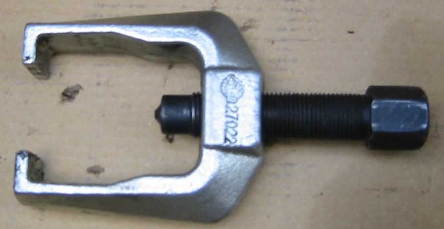

i use a puller to remove ball joints normally but i find just a hammer is fine if i have it on the bench, with the control arm out with the ball joint still attached to it. just be careful when using the hammer that you don't hit and split open the rubber boot on the ball joint or else you'll have to replace it.
when i do use a puller, it looks something like this:
if you use it, make sure the hooks have lots to grip and that it doesn't get cock-eyed as you tighten the point down on the stud of the ball joint. tighten it until the ball joint either pops out or until it's snug. if it comes up snug but the stud doesn't pop out of the control arm, take a hammer and whack the side of the control arm where the stud passes through. this will momentarily deform the hole the stud sits in and, paired with the pressure from the puller, the ball joint will pop out.
Jarf
Posts: 354
Joined: Sat Jun 21, 2008 9:20 pm
My tercel:: Currently without
Location: Ontario
Re: *?!@#! Control Arm Bolts Just Spin - AARGH!
Post by Jarf »
SWJ - your getting great advice here.
Good policy is to put the retaining nut back onto the stud, so that the top of the nut is flush with the top of the stud.
Saves damaging the threads form hammer blows or deforming (mushrooming) the top of the stud from puller point-load distortion.
The best method to separate joints is the 2 hammer method, hold a big one against the back side and use a good FORD hammer for the "front side".
The hammer on the back side is critical for EASY separation.
Shouldn't tale more than 1-2 whacks though I have had some particularly stubborn ones that required 5-6.
Having tension on the joint helps a great deal.
The idea here is to have a load applied to the joint in the direction you want it to move (separate).
Then the hammer blow is there to make the hole around the stud flex just enough to momentarily "let go" of the stud.
Same goes for the puller method, put some tension on the pin and give it a whack.
You do want to avoid cranking hard on the puller, just load it up a little and give it a whack.
The point of having the 2nd (same size or larger) hammer on the backside, is to absorb the blow and reflect it back into the joint, it will make life a LOT easier.
NEVER, EVER use a "pickle fork" unless you are planning on replacing the joint as they ALWAYS split the boot.
Also, care must be taken with that FORD hammer, as you don't want to destroy anything else in the process, backing plates always seem to jump into the way for some reason.
PS: a FORD hammer is the biggest one in your tool box, you're looking for something on the order of at least 1lb.
