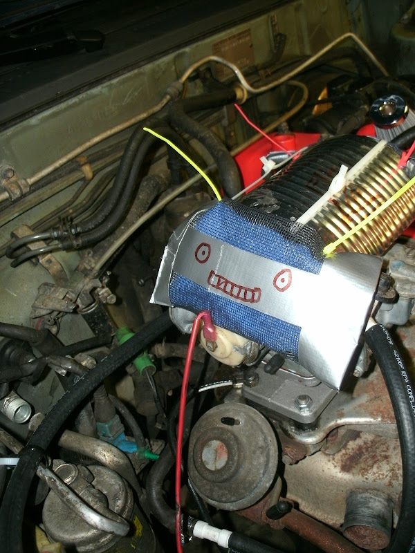

I got the weber installed with my MacGyver brand air filter. Accelerating up hill at 75 is a joy I thought I would never experience again.

Boy - talk about a two-faced air filter ! ! !
Well, in the Army we called it "Field Expediency." Bravo!

Thanks Lil Beast, those pics are helpful. Everyone gets a laugh out of it, I almost don't want to change it because my girlfriend loves it, but I'd rather have a proper air filter.
