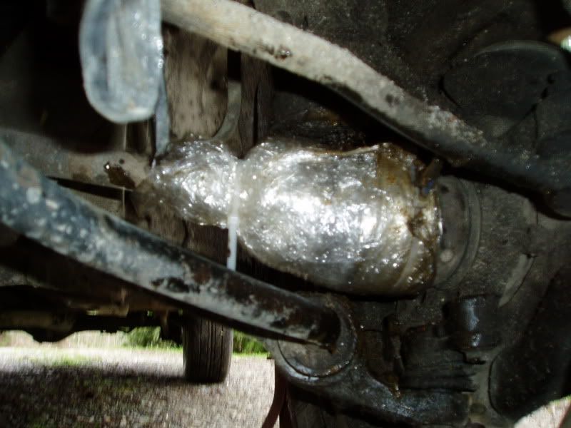

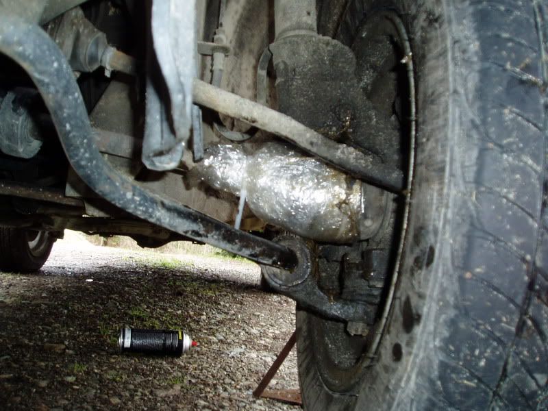

Re: CV boot replacement questions
I was inspecting under my car this morning and discovered a damaged boot (on an axle with good cv joints). So inspired by David Lucas Barns I did my own "instant boot" repair. I cleaned off the outside of the boot and wrapped about 10 or 12 layers of heavy duty saran wrap around the boot (I jacked the tire up and rotated the wheel so it wrapped in the direction of rotation). Than tied it off with a couple of zip-ties. I do not know how long it will hold up, but it only took a few min to install and should be stronger than the baggie, more flexible anyway.
