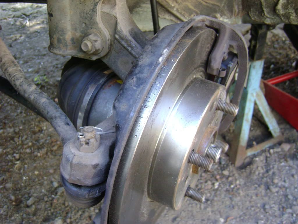

Yes! Thank you splatter. Napa has the hoses coming in the morning amazingly enough (9 bucks a piece) The old ones came off very easy, I'm replacing the pass side caliper, it has a fairly decent leak from the piston, I hope to rebuild it since it's a stock Toyota caliper (says right on the top) but for times sake (gotta hit the road soon) I'm putting a reman on...I have no idea yet what brand (my guess Asian)

Here's a cool fix I did thanks to an idea via splatter:

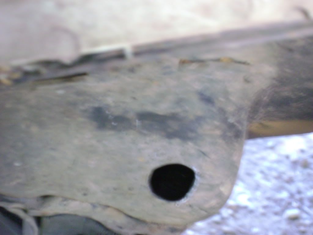

one of the body bolts stripped out, so I cut the smallest access whole I could with a drill and then put a new bolt and nut on...good as new I think.

I would put a rubber body plug in the access hole to keep crap out. Couldn't hurt to spray a little paint first.

Adding to splatterdog's advice - a number of the OE body plugs were missing when I got Goldie. I used rubber plugs of various sizes and a few crutch tips to plug 'em, all from Home Depot.
Where the oblong subframe/Xmember was open at the far back under the hatch and behind the tank, I cleaned it well, sprayed RustOleum Rust Reformer inside, covered the big oblong holes with duct tape and then sprayed them. Still holding after almost 5 years.
