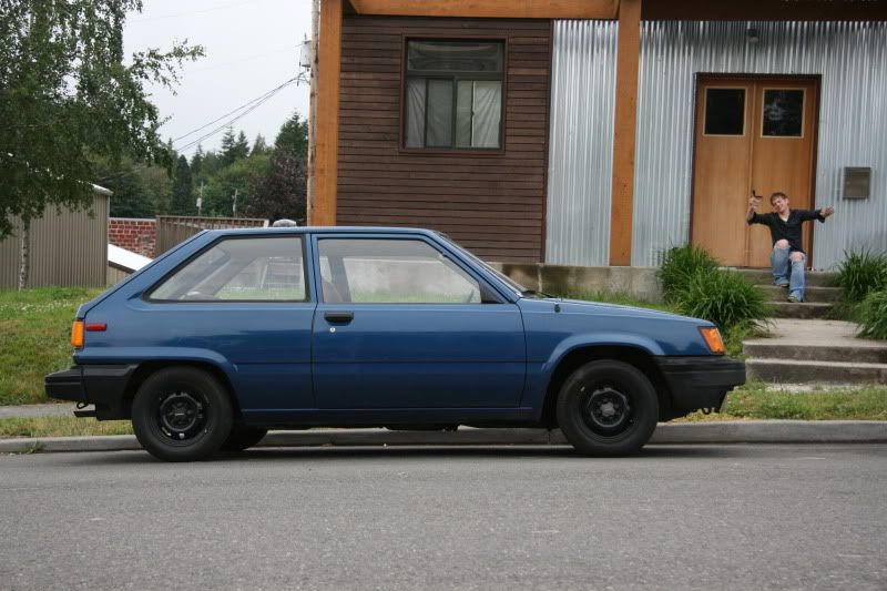

I've seen people swap the 4age into 4wd tec's, and I know the 85fwd from firewall forward is basically the same as the 4wd version, but what about the transmission? Will the 4age line up with a fwd transmission? This so far is my only hesitation to poring crazy amounts of money into my little blue berry for a 4age swap...

I've removed the backseat for more storage room plus I'm about to throw in $200 of second skin sound dampening. I want to be sure I can do something with this car when it comes to speed and maybe a mpg boost. If I can find a plan for the swap, I'll totally take those side plates off your hands.
