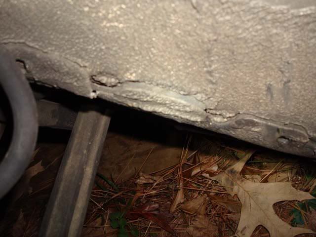

This is top or forward part of where the control arm box attaches to the frame.

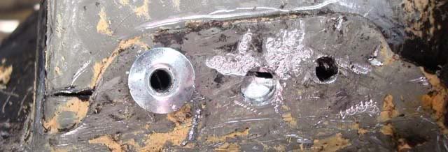

This is the box near the bottom. Note that it looks like it may have been welded here before. The weld is cracked. The cracked weld would have been done at the factory as it had the factory coating over it.

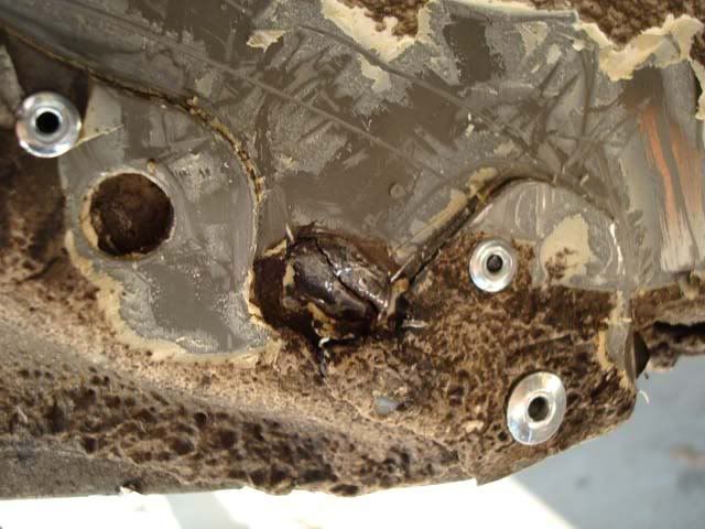

This is the front of the control arm box looking straight up. The frame is also cracked, you can see the crack through the hole I started to drill for a pop rivet. BTW the pop rivets are just to make it safe enough to drive to the shop.

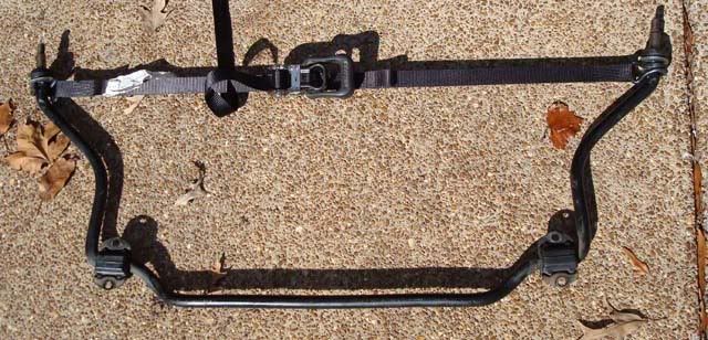

For those who have changed your sway bar bushings, is that sway bar supposed to be about 4" wider that the spacing of the holes in the control arms? I had to squeeze it in. How do you like this trick, used a cargo strap with a turn buckle. I balanced the bar on the floor jack while I put it in place and bolted it down.

Before you weld it, you should find the end of each crack and drill a small hole there. This is important to do before you weld it.
This is called "stop-drilling" and it will not allow the crack to propagate any further. Even with welding, the crack end is a huge stress riser. The crack will usually continue to propagate right through the new welds if you do not stop-drill the crack ends first. You can fill-in the holes with weld when he does the repair.
Also the welder needs the same thickness of metal because on metal so thin, by the time you get the thicker one hot enough to weld, you have already blown a hole right through the thinner part. When they are the same thickness they will heat up the same amount and can be welded. On thicker metal you can concentrate the heat more on the heaver part, but on thin sheet metal it is almost impossible to do even with a skilled welder.

I, too, used the cargo strap improvisation on the swaybar; the only difference is that I had the swaybar
inserted on one side and the two brackets mounted - your method may have been (relatively) easier.

The two swaybars I dealt with ALMOST fit...the used one I put in was apparently tweaked a little in an accident, but I forced it to fit by hand and maybe using a jack.
As far as those bushings on the ends...they can be shimmed some using rubber sheet material washers...I also made a cylindrical steel shim to go over the threaded end to help snug that part up some. Just need to be sure they still have the ability to flex a lot...so you don't put too much stress on the threaded ends of the bar?

Petros wrote:Before you weld it, you should find the end of each crack and drill a small hole there. This is important to do before you weld it.
I did do the stop drilling, but some of the cracks have gone full circle already. As for the welding, I'm only going to have tack welds done, no seam welding. The tacks are actually stronger than seams when doing thin metal, so for this reason, the patch can be thicker.
I wish I could take the car to work and get one of our welders to do the job. We have some of the best welders around working there. They do weld rather think parts to sheet metal i.e. 1/2" thick hangers to 12 ga., without blowing holes through the tanks. The tanks have to be oil tight. I think I will do the doubler in 14 ga. though rather than 10.
