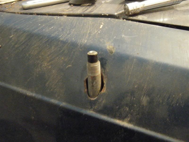

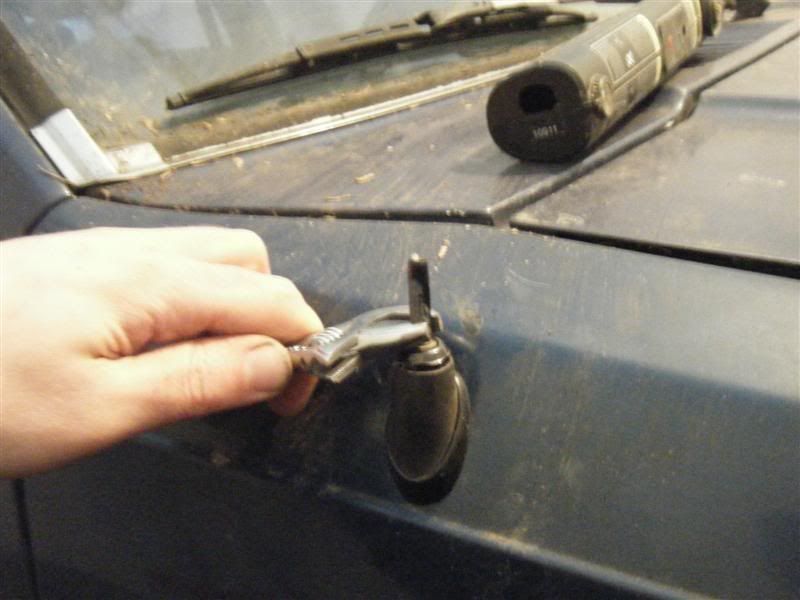

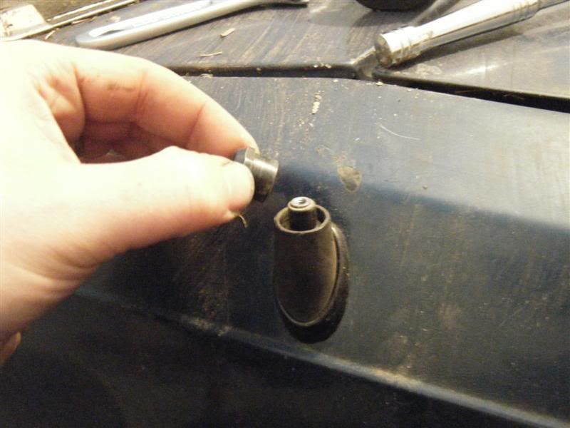

just had to mess with this on reggie (the project car). it was all broken, flopping around, and had another antenna taped to it so i wasn't sure what should be there and what shouldn't. figured it out though and took some pics.
first, there are flats on the antenna itself. use a small wrench to unscrew it from the antenna base.
then use a 15 mm socket or wrench to take the retaining nut off. this nut pushes against the plastic trim pieces at the base of the antenna and pulls the hooks on the underside of the base against the fender. you'll see what i mean in a second.
