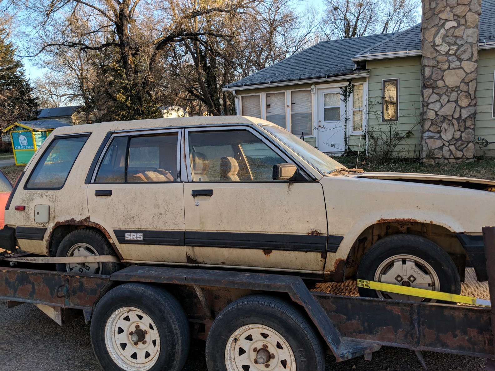

Hey Chard & Diarmait,
The fellow who purchased the south KS Tercel needs to move it. No title, pretty rough, but I’ve indicated I would come save what I could for $$ and presumably he would scrap the rest. Any thoughts?? It shouldn’t be too bad to drop the tranny, any tricks? I assume the wheels are 13”?

Take it all! Not worth very much in scrap, around here it's been 30-40 per ton for months. Those alloys should be 13's.

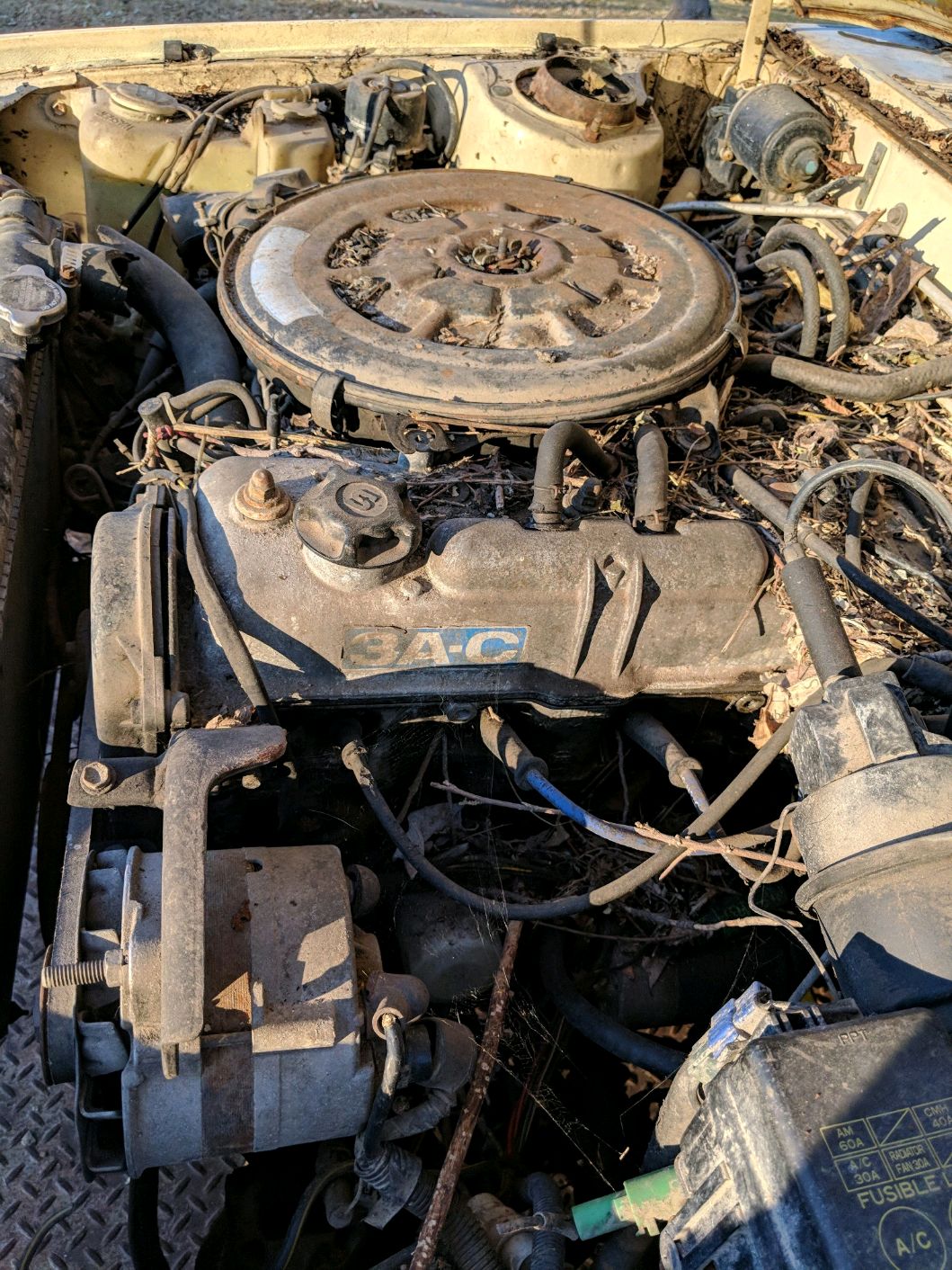

Chris,
I would be interested in parts and I am needing a good engine for my red 84'. That car appears to have cruise control that someone may be interested in. The tranny should not be too difficult to drop. I could potentially help you as I am not that far away. That would appear to be an 83 or 84 so the finals will be 3.73. And yes those wheels are 13". Oddly enough, one of my cars has just one wheel like that. If you have room, offer to take the whole thing.

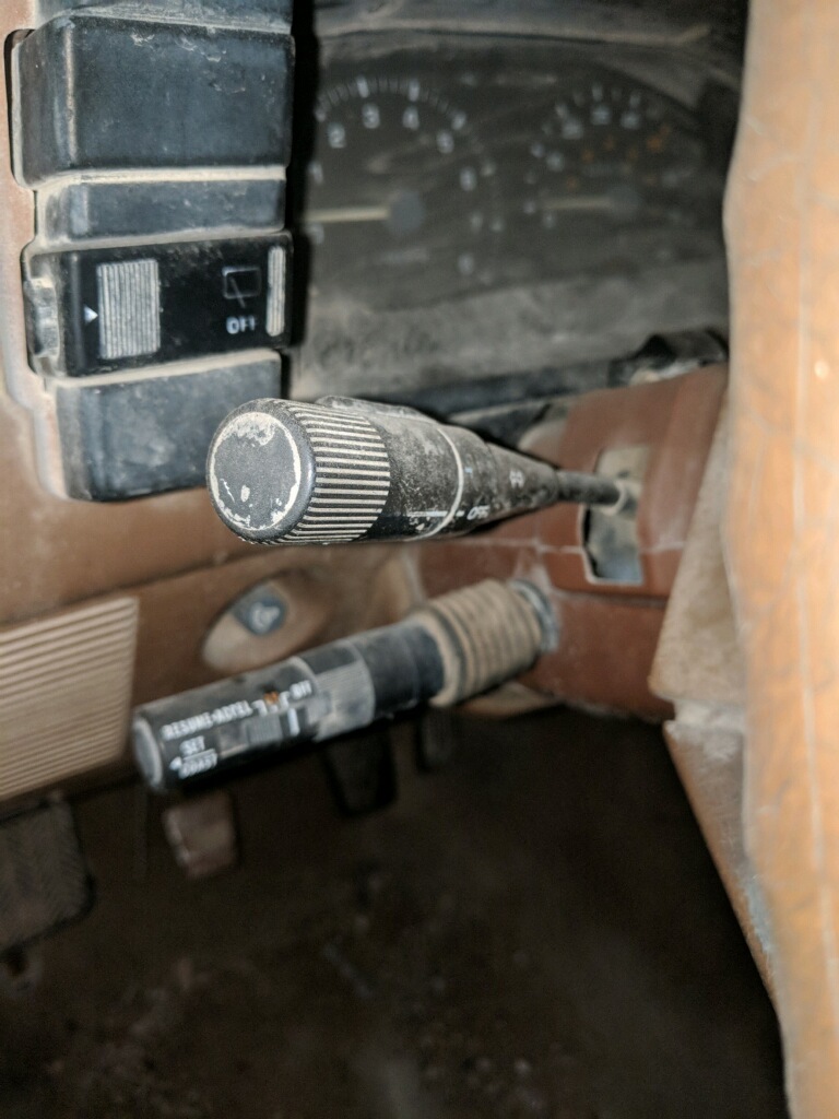

I was really hoping for adjustable intermittent wipers when I noticed the cruise control, but no such luck. Here is a pic of the cruise lever.

That was definitely aftermarket cruise!

Ironwiki,
It sure is
