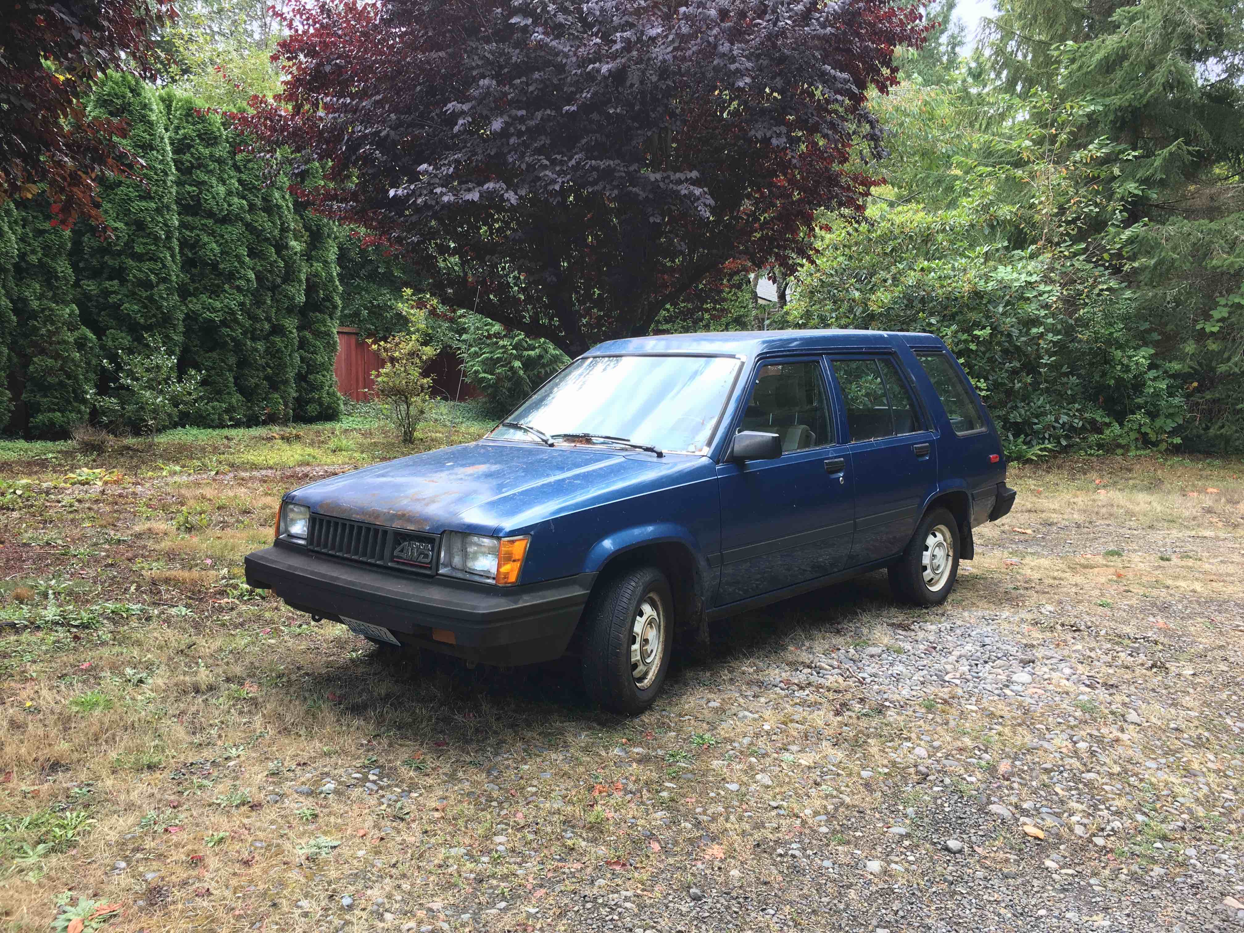

bought this lil guy a little less than a year ago and have been a bit overwhelmed by mechanic's inspection. Posting for guidance, and/or interested parties.
runs and drives! but work is needed to make it a daily driver.
mechanic's inspection revealed:
"carb float level is too high, needs to be adjusted.
radiator is cracked in multiple spots, about to blow
sway bar bushings are cracked
brakes are squishy due to master cylinder
needs front brakes
rear brakes need to be adjusted
brake light is on due to low brake fluid
valve cover gasket is leaking
distributor o-ring is leaking
front crankshaft seal is leaking; needs timing belt
needs both drive belts
needs lower ball joints
front struts are blown
rear muffler is bad, needs to go to exhaust shop to have a new exhaust from cat converter back
needs tires all the way around
vehicle has a 3al engine, this is from a 83-87 corona or 84-88 carina. these are motors not sold in the u.s. unsure where to buy parts for this."
