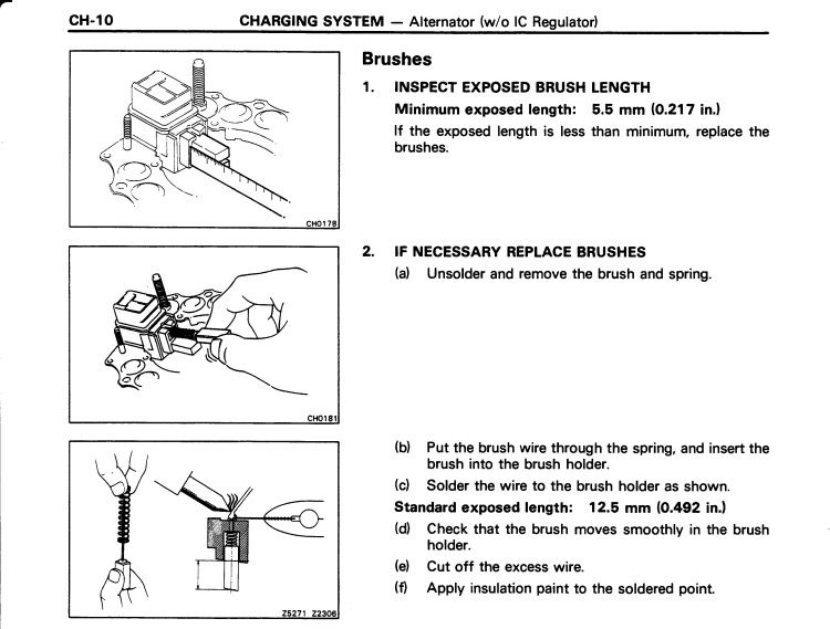

On 80's Toyota's, Toyota built a diode and resistor into the charge light circuit to cause both brake and charge lights to illuminate when the alternator is faulty. Most auto parts stores will test your alternator for free. The most common problem with a worn alternator is worn brushes. They can be purchased for about $5.
