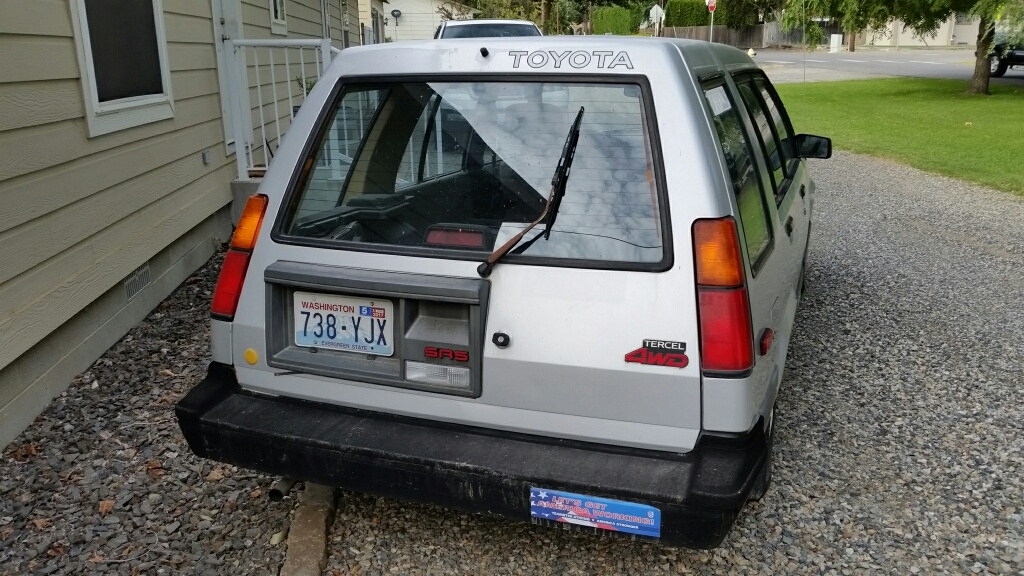

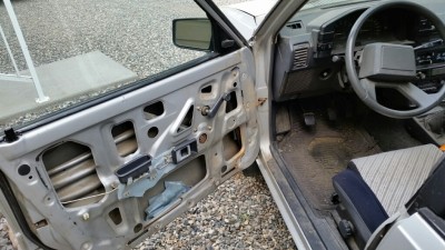

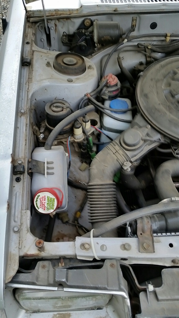

Up for sale 1986 Toyota Tercel. Has a blown head gasket. Still runs good but wouldn't drive it far. Items that have been replaced in the last few years include alternator, muffler, water pump, timing belt, exhaust valves, radiator, heater core. I had to change the overflow tank and washer fluid tank. Drivers door panel off due to the tabs that hold the window to the regulator broke and it's easier to keep the window on track to roll up and down. Vehicle currently has 173889 miles. When gas prices were high was my daily commuter. I have changed the head gasket at least twice and for some reason continue to blow head gaskets. It has some dings and dents. Front windshield is cracked. Hood has been changed. Was told hit a a deer. When running good will drives great. Will do 75 mph and average about 23 mpg. Possibly the head has a crack because the same problem keeps occurring. Never had any transmission problem (5-speed) and last November filled with fluid. It is 4wd but I've actually never put it in. Just ready to move on to something newer and would like to see the Tercel go to someone who could use the parts or continue to run it. It's about due for new tires. Has current tabs. Make an offer. Would rather not part it out. Hate to send it to the wrecking yard. Email dustytrailadventurer@gmail.com with questions. Thanks for looking.
