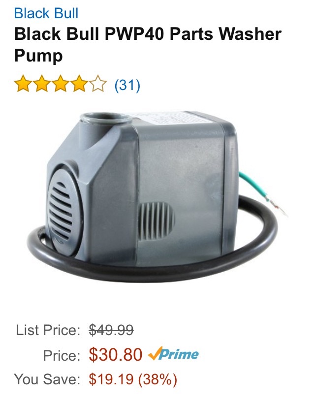

I'd be interested in seeing what you use as a parts washer, pictures would be even better. Many find the $50 Harbor Freight model works fine and I would've gone that route too if I didn't already have a metal cart with casters, a utility sink with a small hole in the side, lots of plumbing leftovers, and a remote oil filter mounting bracket. Amazon delivered my pump today and I'll have time this weekend to wire up a switch. I also found a flow thru brush online.

What is the link to the pump you posted on Amazon? Maybe I could adapt it.

The link to dotheton.com is a motorcycle forum. It's an example of someone who went all out on their build: reinforced the legs, filter, added shelf, all black paint. I don't think I will go that far.
I bought a 40 gal solvent pump from Black Bull via Amazon PWP40

Thanks for the link; I will investigate further to see if it will work on my washer!
