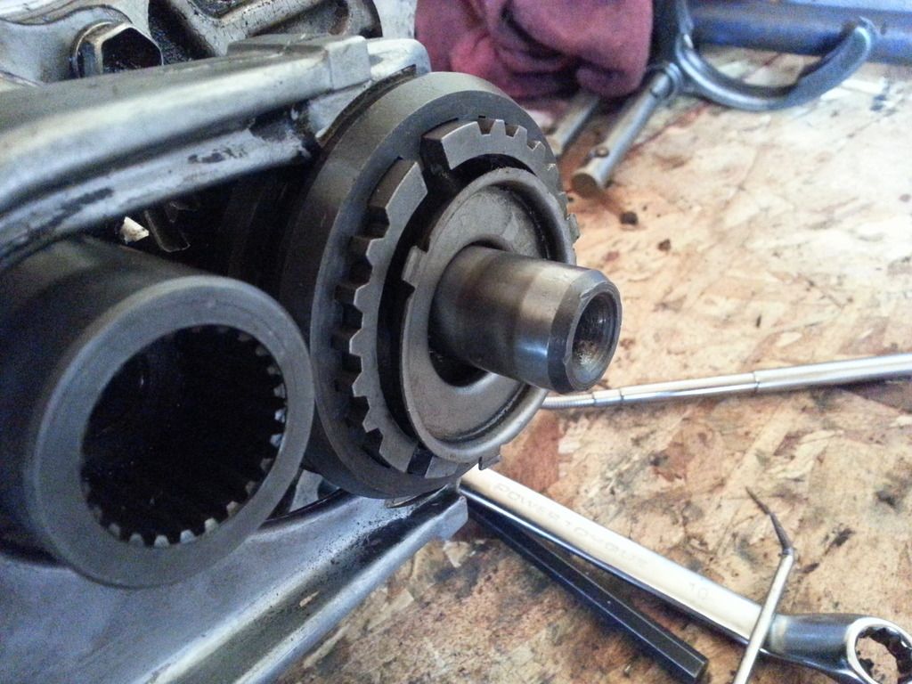

we took out the tranny and can find nothing wrong with it but this dent on the pilot shaft. Will the small dent cause the noise?

I cannot see the dent very well
looks like its on the bearing surface for the inner bearing
i can see where the rollers ride
is it very flat with no sign of missing metal besides that dent
on input shafts that i have seen that are going bad, the wear pattern has dents like that but a lot more of them than one
also if surface is not dead flat but dished or grooved even slightly then it is going bad

save that input shaft for the future
a machinist can sleeve it for under 100.00

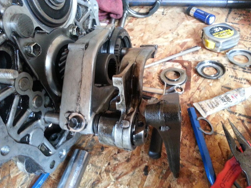

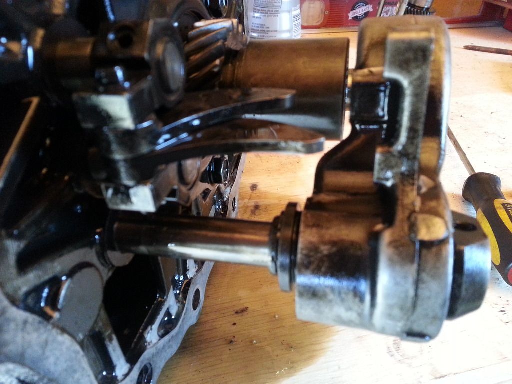

Well the tranny is almost all back together.
Can't seem to get the last snap ring to go on 5th the one that holds the cover for the detent's

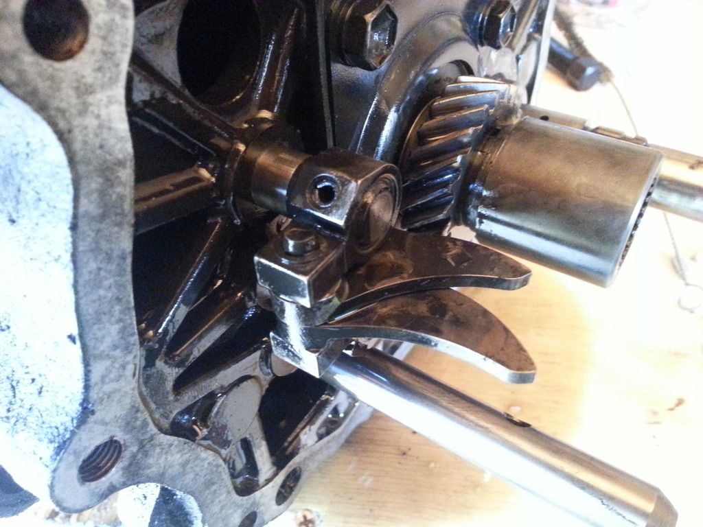

Ended up that one of the trannys had steel forks with roll pins holding forks to rod's, While the donor tranny had aluminum forks with bolts holding the forks to the rod's. You can't mix up these parts it's one or the other the races for the forks are wider on the aluminum forks! And rod holes are threaded for a bolt rather than a roll pin.
Took 5th gear off another tranny all together and yet again the internal parts are not a carbon copy's. The last tranny has a VERY different look the end of each shift fork rod sticking out of the main case has "collars with little swinging things on them"
Notice the three different styles of 5th forks! Looks like Toyota tried to made small improvements through the years.The one in the middle matches the photo above it has a spring mechanism on the through hole and a 90 degree back or rib if you will
It's hard for me to get my head around the engineering that goes into these things! All the little bits and pieces joined together to complete a single task
. Forum member hwy1tercel deserves most of the credit for the hands on work on this rebuild but ultimately we did it together(with the help from Bob's videos of course)

Those claw shaped swinging things are the things that lock the tranny in gear when it happens, thats what I found in the tranny mine came with, so I have my old tranny with that same shit, but its 3rd and 4th gears are trashed . . .
