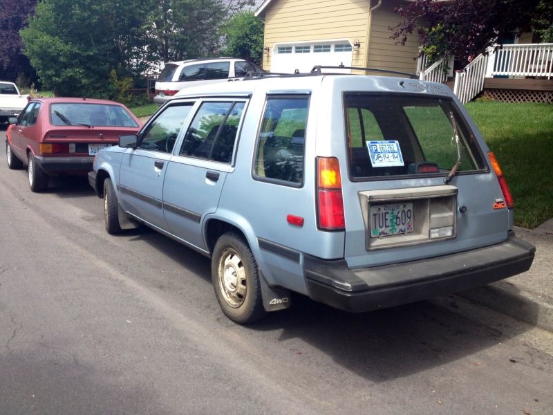

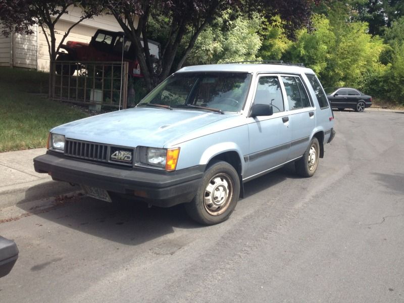

Just picked this up yesterday.. Guy was asking $850 and I ended up getting it for $550. It has 314k, apparently was owned by a preacher before the guy I got it from. Fairly straight for the amount of miles, interior could use a good cleaning. Little bit of smoke on start up but it smells kind of gassy and idles a little rough so I think it may be carb related? My plans for it are a slight lift, some 14's with bigger tires, I have a yakima rack for it, probably some off road lights and just a general tidying up of everything. I want to fix the rough running/bogging at low rpms, and probably do a head gasket, water pump, and timing belt just for peace of mind since I don't have any service history and the high miles. The fuel gauge doesn't read quite right and temp gauge only goes up to about 1/5 of the full span once running so I'll have to figure that out. Sometimes its hard to get it out of 4wd, but other times it comes out just fine. I just want it to be a daily driver that can manage logging roads and trails on the weekends. Currently my leg is broken and will be another month or two before I'm back full duty so I'll spend some time here getting versed as this is my first Toyota after owning 20+ VW's. Anyways onto the pictures.
Image you can see my other ride in the background, 1980 Scirocco with a 2.0l 16v from a 91' passat, still a work in progress.

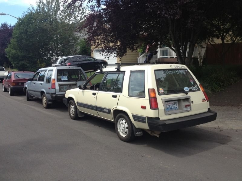

Image Here is my friends sr5, definitely will be some Tercel trips this fall when I'm able.

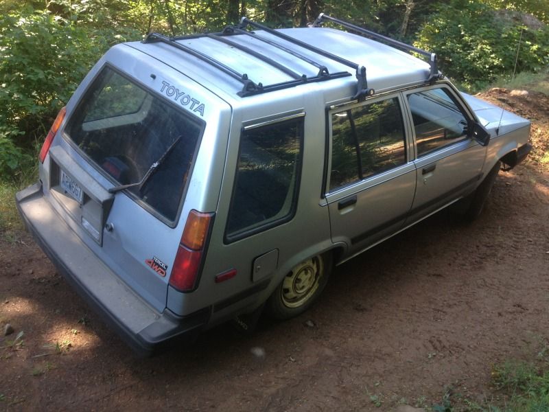

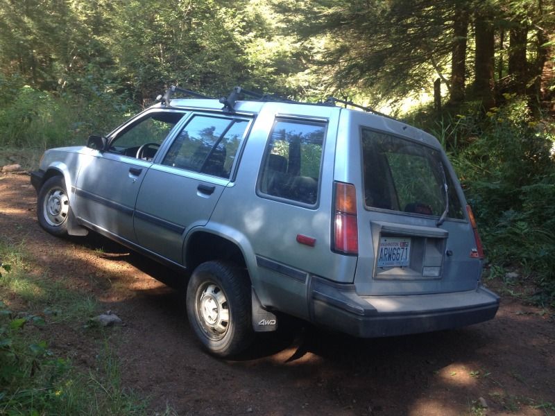

Haven't been on here much lately, but my leg is closer to being healed and I went out and did some off roading in the Terd yesterday..
