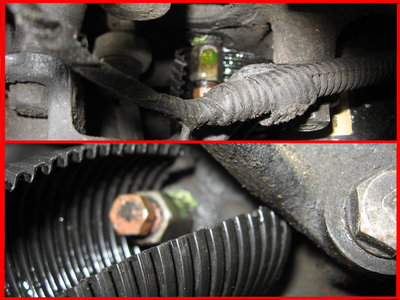

Previous draining of the engine drain cock resulted in a mess and also impossible to catch the AF for disposal.
I tried hoses in the past with no success.

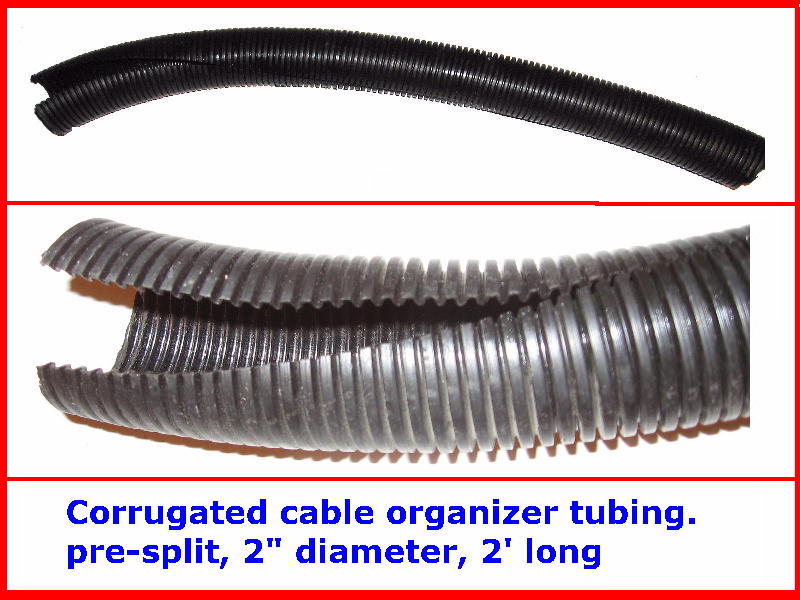

So - I had quite a bit of this tubing left over from the bike shop (not used for cable organization, its intended purpose) and the lightbulb went off!
It worked great, but it does have to be held in place as it tended to slip.
This should be available by the foot at computer supply places - or possibly electrical supply houses as well. Grainger carries it, but you might have to buy 10'.
