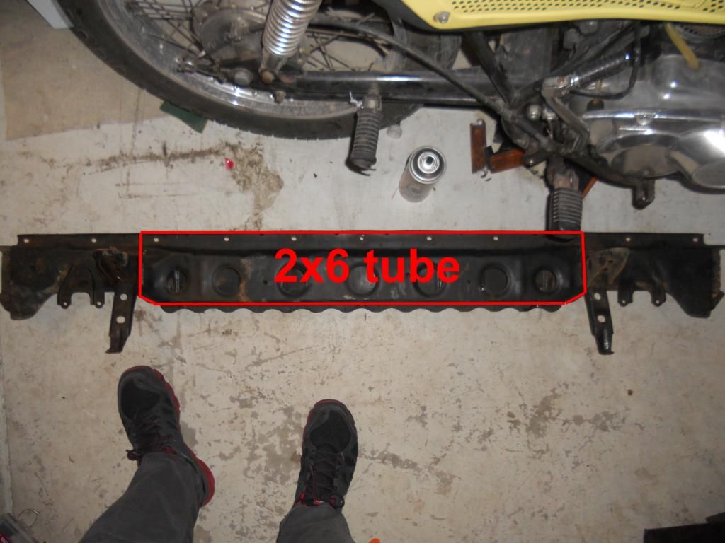

I got this design from the tow hitch on my unit body cherokee.
The 2x6 box tubing is going to be welded into the brackets, then the origonal bumper will have a section cut out of it for the tube to sink into.
I'm thinking sleeper winch bumper, but not as sleeper as what they have factory in other countries. what do you guys think?

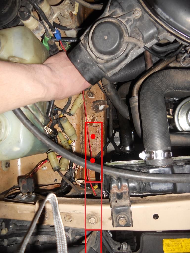

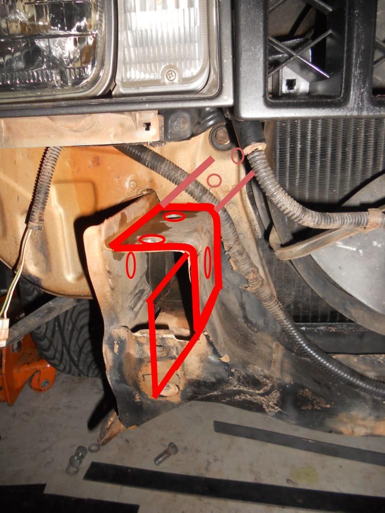

I think I just thought of something even better then my first ideas, but I have to go to work and leave for LA. Crap. Anyways, I'm thinking of making a bracket that connects to the recover tabs (three bolts) and then back into the inner fender well area, where it will bolt into the unit body frame rails through the sides. more simplistic. I will have to move some power steering lines out of the way, and the body rails kind of tapper out towards the front, so the bumper might have to be installed from the ground up instead of being pushed on.

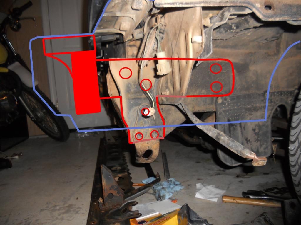

Here's what I cam up with.
Blue lines represent the plastic bumper, and the red lines show the bumper bracket. the solid red boxes represent the the box tubing. I did not sketch in the original bumper, because it would complicate the image, but it will be utilized.

Looks like you definitely have some skills when it comes to fab work.

you might consider on your bumper a single bar that rises off the top at one end, loops across the front at radiator cap height, and than turns down and welds to the other side. It will protect the head lights, side marker lights, and keep deer off the radiator and hood when they wander on to the road.
hitting a deer is hard on the radiator and body work.

Good idea petros! Maybe I can find away to make the hoop a bolt on part of the bumper so I can still use the plastic bumper skin.
