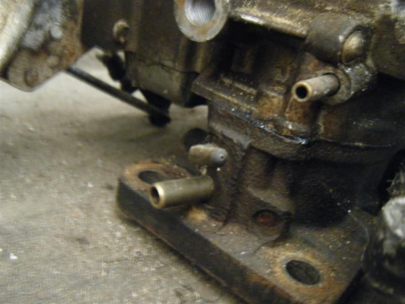

here is a pic of the choke breaker A port from a carb that does not use the 'jet' restriction device. you can see it has only a pinhole opening compared to the regular port above it. i have not noticed a trend on which years use it but i believe this carb is from a canadian automatic so that might have something to do with it.

It is a very good idea to have the jet in place, or a very small orifice in the line, to the choke breaker as a backfire is very likely to destroy the diaphragm in the CB w/o some kind of protection. The CB assy's are getting hard to find and very pricy.
