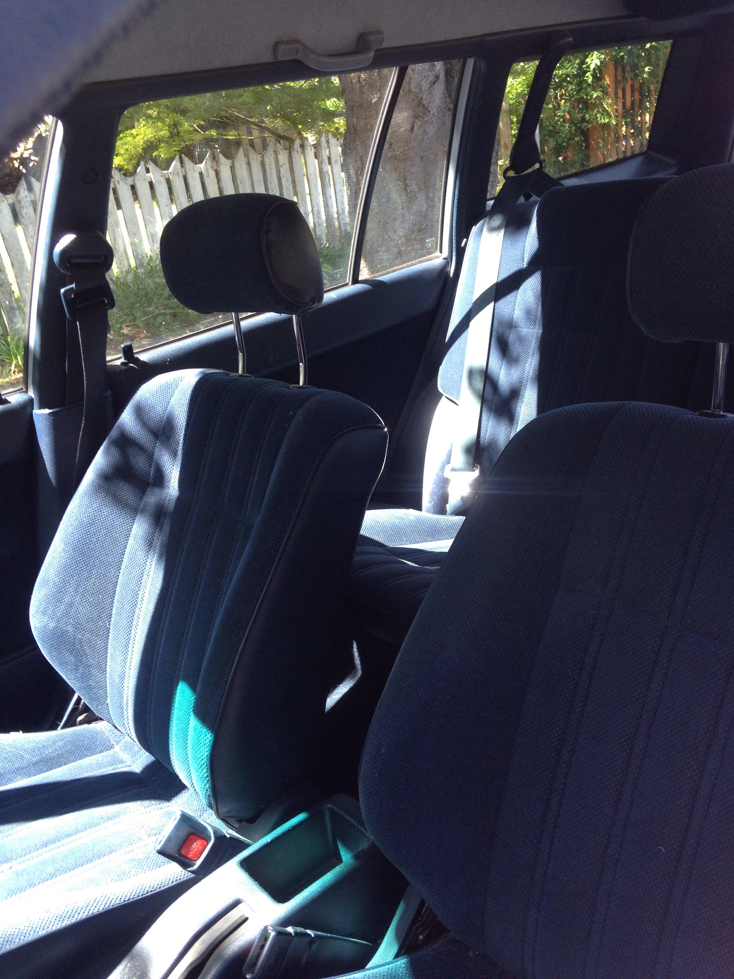

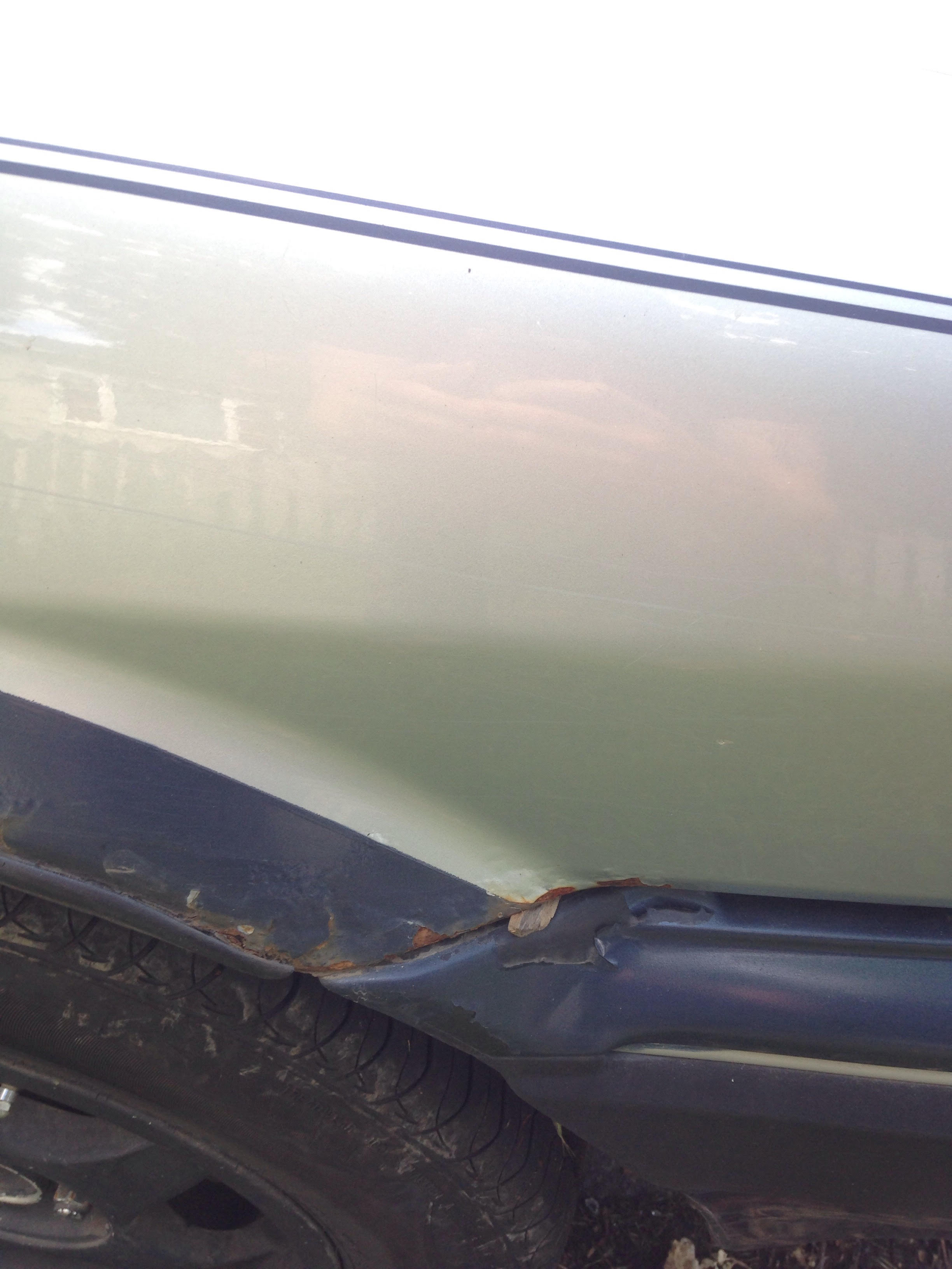

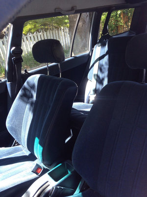

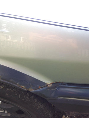

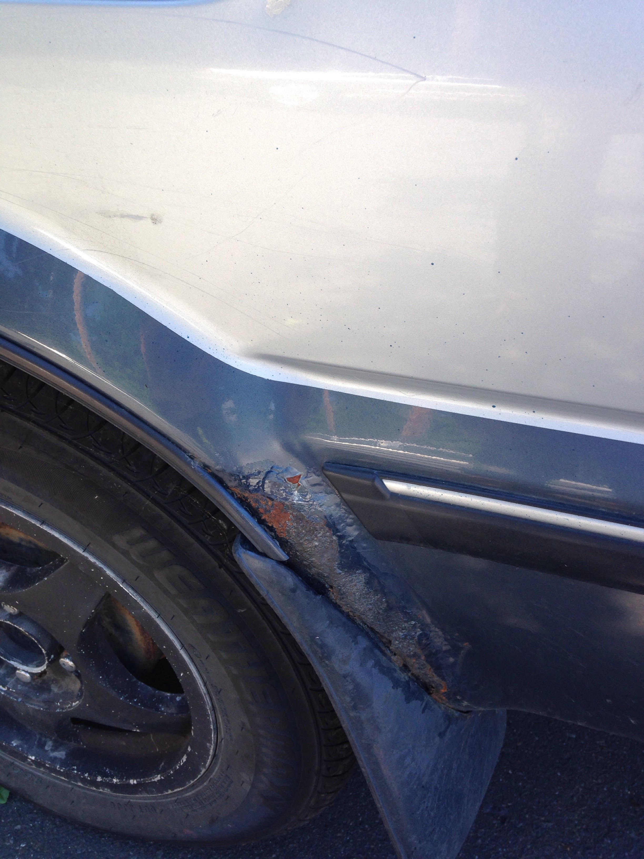

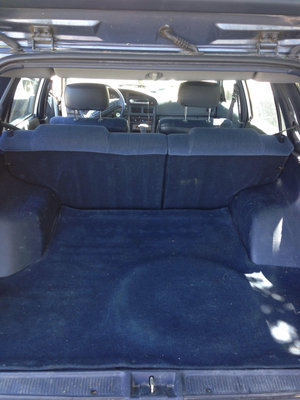

1993 Corolla All-Trac wagon, with 194,000 km. $2950 CAD. Automatic. Has some rust around the wheel wells. Owner emailed additional pics, which are attached. http://www.usedvictoria.com/classified- ... 4_29591506
1988 Corolla All-Trac wagon, with 280,000 km (not in ad, but owner confimed via email). $300 CAD. Manual (owner also confimed via email). Apparently doesn't run, owner suspects fuel pump.
https://victoria.craigslist.ca/pts/6167117858.html
Question: is a transmission swap difficult for these? Would it be possible to convert the '93 to manual with parts from the '88?
