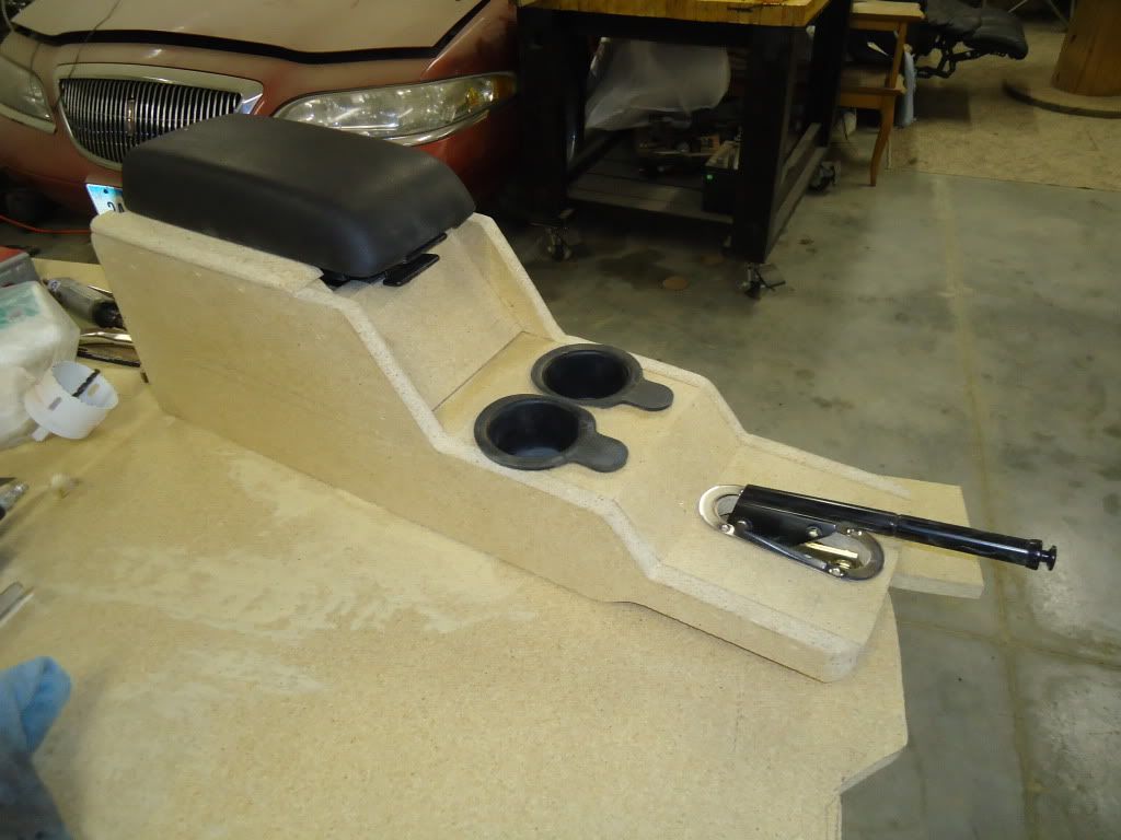

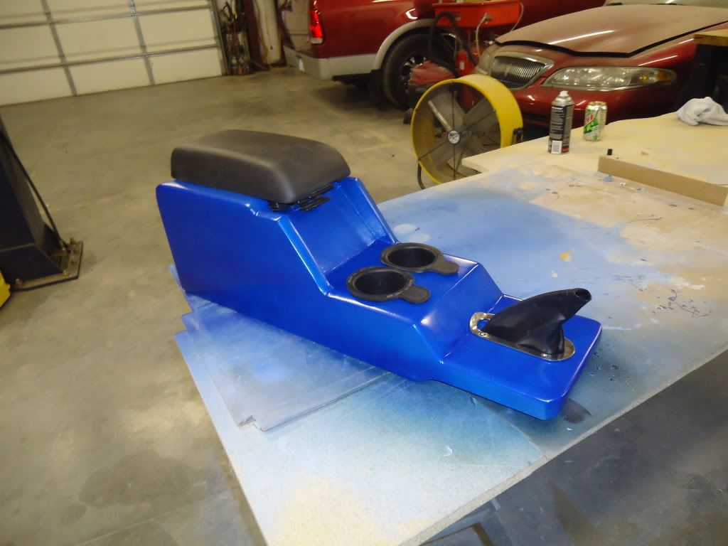

you will either have to modify another console from another car (that is about the right size) to fit in the Tercel, or you will have to make one.
I have seen custom consoles made to hold extra gauges and switches. make a pattern with correlated cardboard, than make one out of 1/4 or even 1/8 plywood (marine grade would be the best if you can get it), glue and screw it together with corner strips of wood. Than glue on a thin layer of foam, and than a layer of vinyl or fabric (or even leather for that custom look!). if done carefully it can look "stock". or you can make it look "high tech".
here is a custom home made center console for a mustage:
mock-up;
assembly;
final "look":
