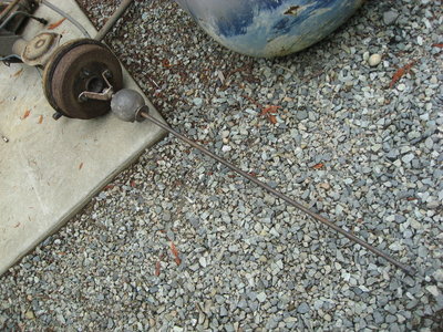

Here is my tool specifically made for this job (circa 2000): It got pulled out of the dusty corner where is has sat for about 10 years, and will be used again this weekend. Made from threaded rod, a drilled-out fishing weight (20lb lead 'cannonball'), the 3-hole steel strap, nuts, and washers. All that's missing is the wheel nuts (and of course the drum would be off, etc).
