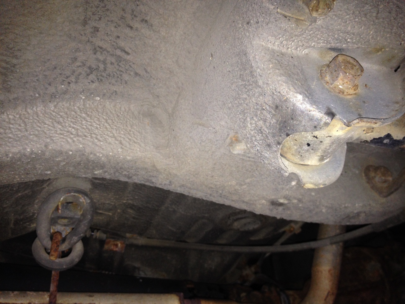

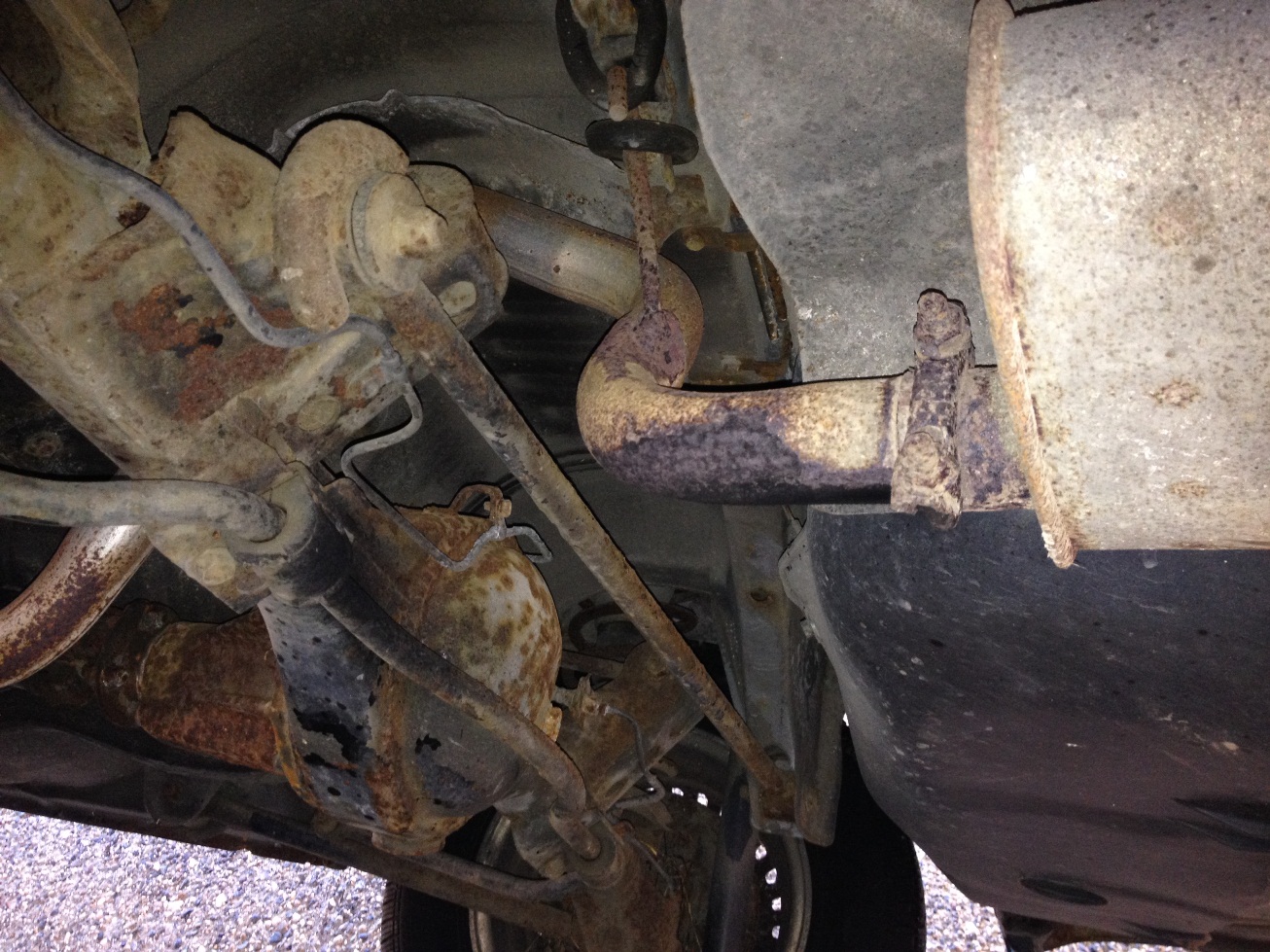

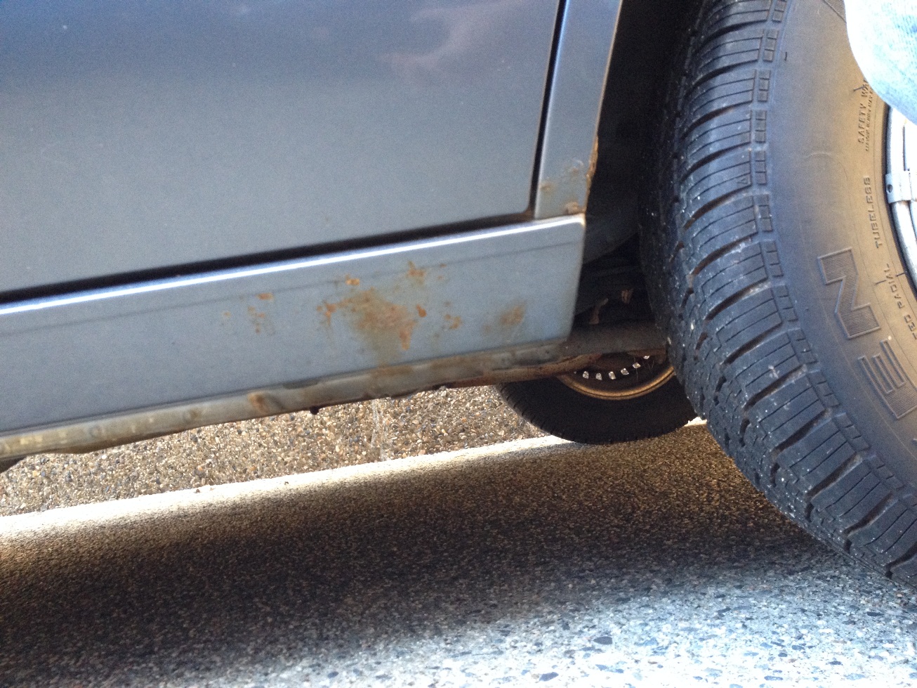

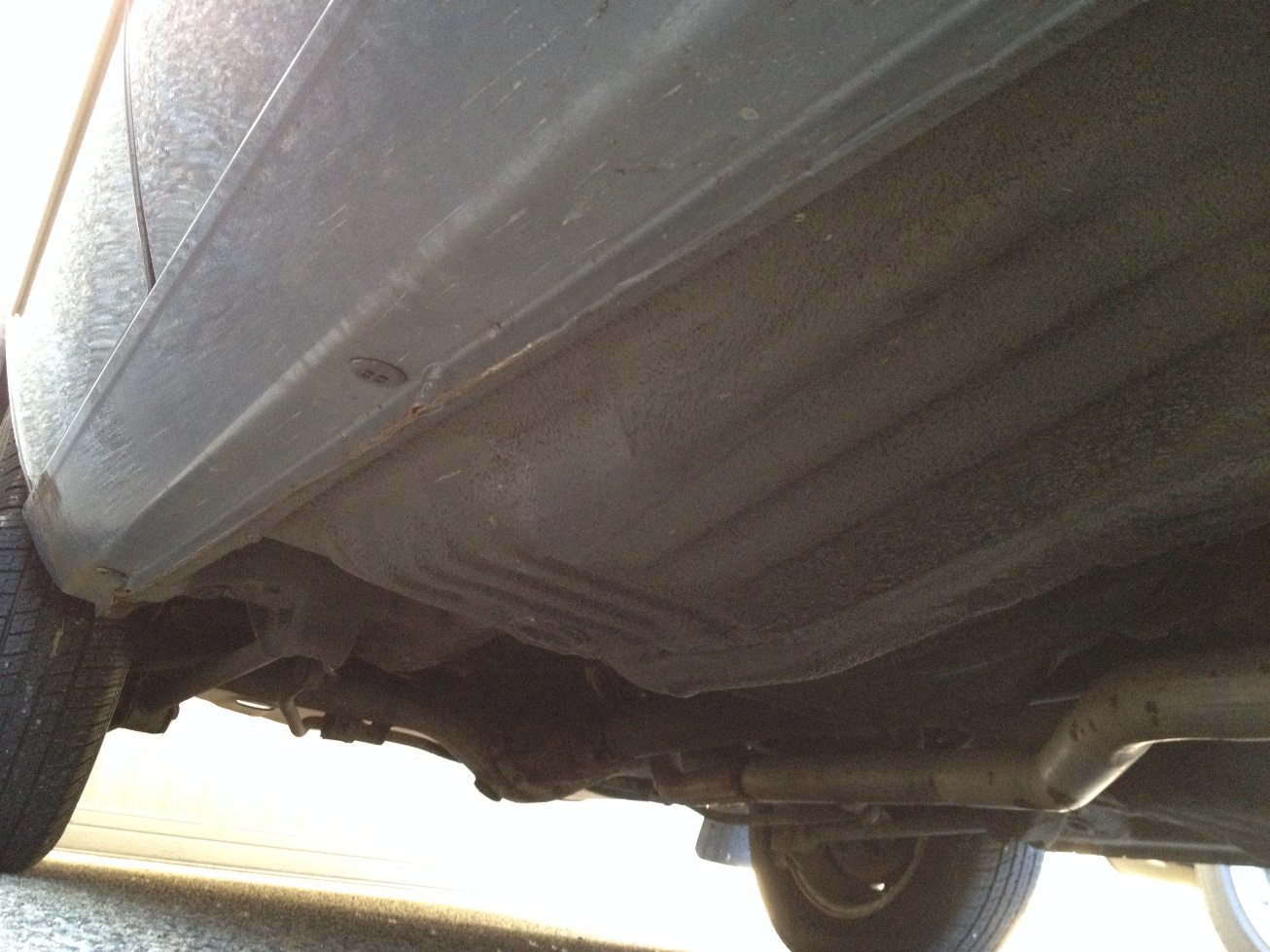

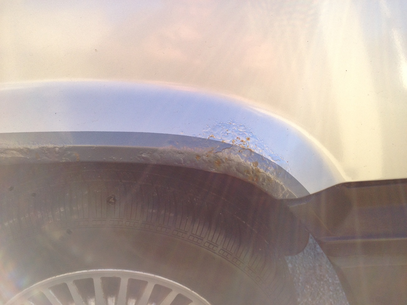

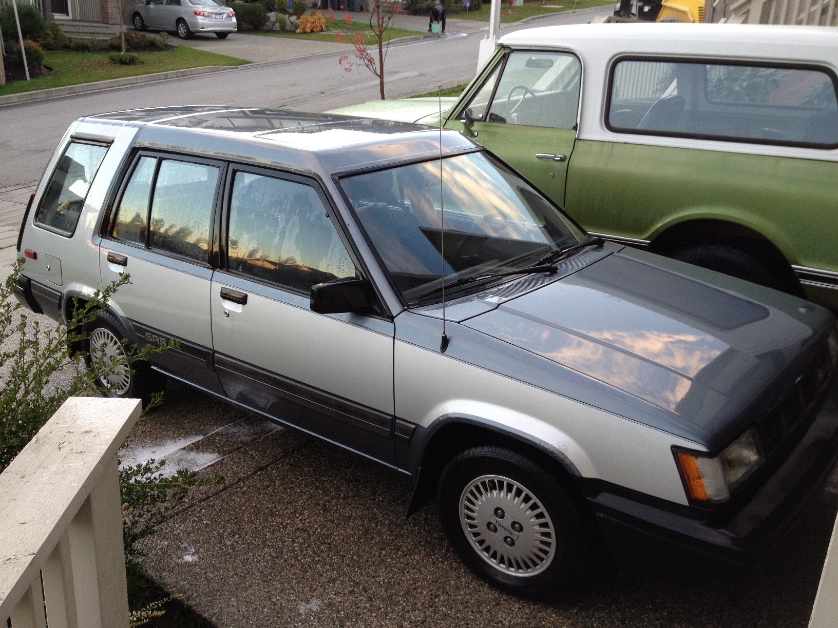

Hi Guys, thanks for the kind words on the car, and the garage.
. I am the seller (well my son and I). He's actually got three including this one, and has decided to sell the two "best" ones to raise a bit of cash and keep the hi-miler beater for himself. That being said, all three are 4WD 6MTs with pwr sunroof. Hard to find one, and he's stumbled onto three...

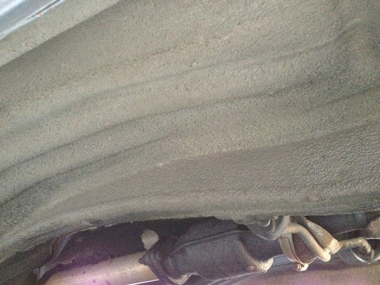

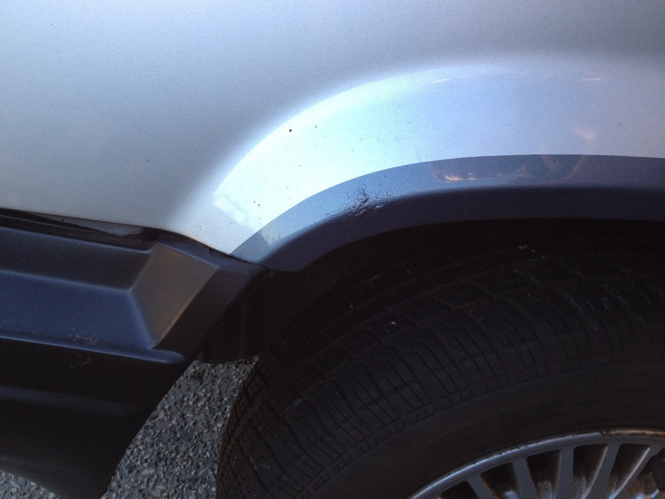

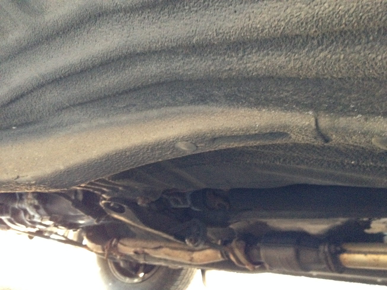

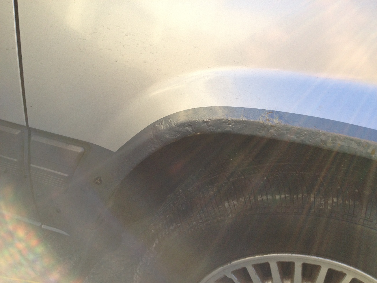

Anyway in case anyone here on the forum is interested in either of these cars, I would be happy to answer any questions, post pics, etc.. As I mentioned in the ad the price is negotiable - what do you ask for one of these in decent shape? Floors, etc., seem to be like new, there's a couple of scabs on the rear rockers, and the R/Fr is the worst spot on the car. Definitely open to offers.
- The other car my son has posted for sale in Kelowna, and someone here picked up on that ad as well, it's on the forum several posts down. I'll put a comment in there as well. That one runs better, very reliable, but needs fenders and has a nasty hole in the driver's rocker at the rear.
Both cars are actually in excellent condition underneath - I've attached some pics I took the other day on this two-toned one.
Thanks;
Len

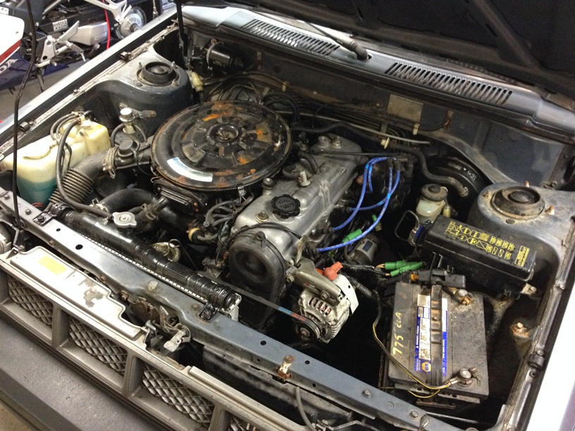

Just an update on this car - I've taken it off CL for the time being. Checked compression today, and #1 has about 50 lbs. The rest are around 190. Guess that could explain a few things... I took the head off this evening expecting to see something, but there's nothing obvious that would point to such low compression in that one cylinder. The valves close, and don't appear to be burnt, piston and walls look OK etc.. I didn't do a wet check, probably should have before taking the head off.
Haven't decided what to do with it yet - whether to fix it or sell it as is. Will keep you posted.

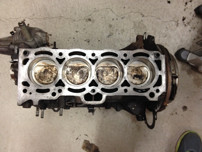

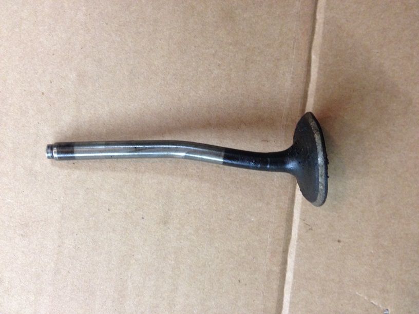

Just an update... With regards to the engine, thank you very much Petros - appreciate your advice. once I had the engine out I figured I might as well have a look inside the original engine to the car, since I had it as well... I found this:
Swallowed #2 intake, but it didn't appear to damage anything but the valve... and this original engine was very clean inside - (I didn't clean those pistons, they looked like that). It spent at least part of it's life behind a motorhome, and I'm not sure what the mileage was when it came out of the car originally.
So I swapped a valve from the runner engine and checked compression - 180 right across. Put it together with a new timing belt, gaskets, etc., new set of plugs and runs like a champ. Better to have the original engine in there anyway. Still may be a few carb issues to work out, seems like secondary may not be opening, but idles nice and drives like a completely different car.
