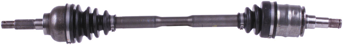

If it is indeed the axles, am I looking at just buying something like this:
http://i.ebayimg.com/t/CARDONE-60-5005- ... ~60_57.JPG
Any bearings, nuts/bolts/washers needed? How complicated is an axle replacement?
Or am I looking at some sort of steering issue?
Are my CV joints finally going out?
