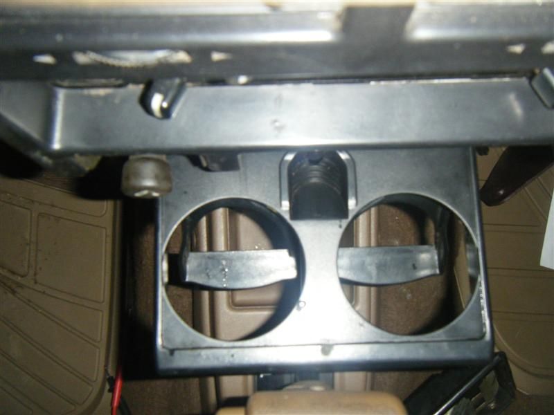

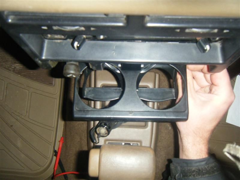

i'm putting the interior back together on the project car and found that, in stock form, the cup holder appears to be completely useless. unless something is bent or not lining up properly, even when fully extended the holes for the cups are obscured by the various trim above it. you can't fit any cups in!
so i thought about the best way to extend the cup holder. i thought about adding a spacer between the cup holder and console frame and using longer screws but that was too much work and might interfere with the trim that covers it. i decided to modify the cup holder housing so that the stops are 2-3 cm farther out. this does mean the cup holder is not able to bare as much weight but i tested it and it is still able to handle far more than you could ever fit in it. you just can't lean on the thing, which you couldn't do before anyway.

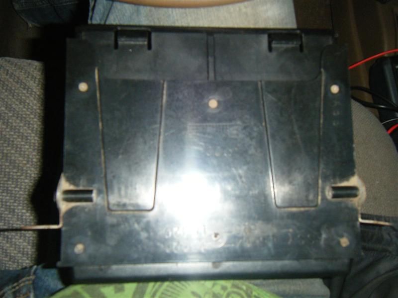

here are the stock stops. the raised hooks at the top of the photo are stopped by the lower sort of v-shaped portion of the housing.

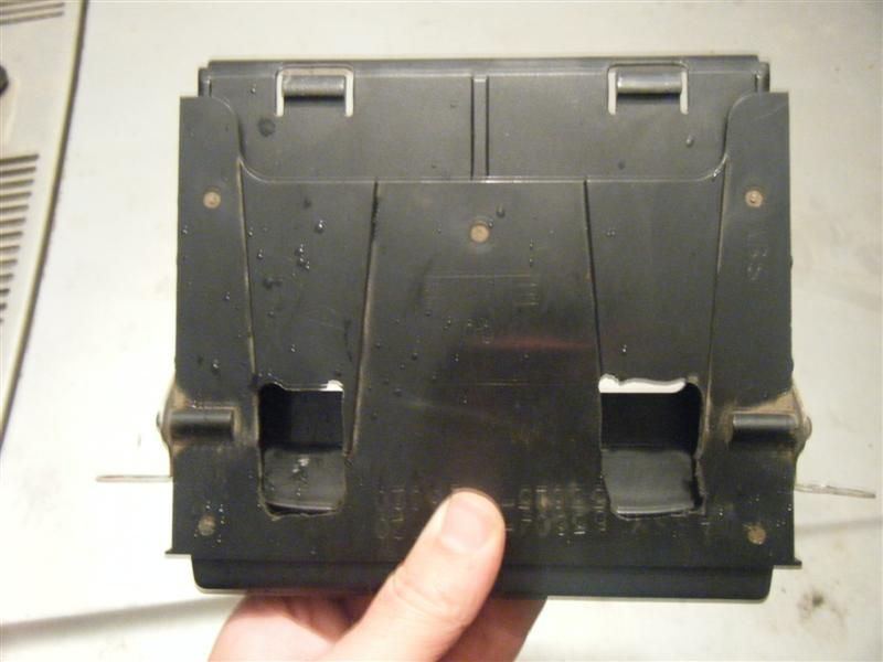

here it is again with my very, very careful and extremely precise mod.
now the cup holder comes out far enough that you can actually use it, and still does not contact the shifter.
