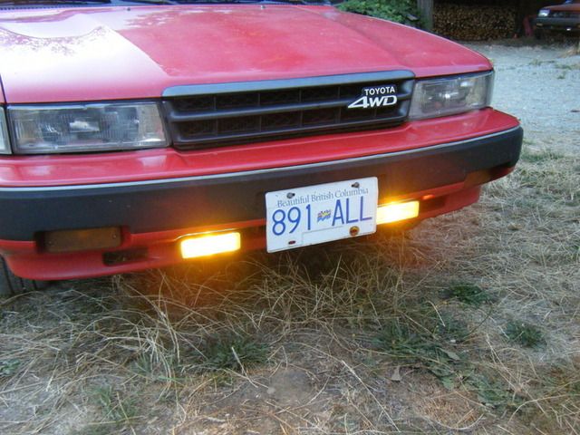

my all trac came with fog lights but the PO warned me that they weren't wired correctly, stayed on when the car was off, and might be a fire hazard. i found one of the bulbs was not just broken but replaced with a totally incorrect bulb--someone had shoved a 194 (typical for dash and marker light applications) into the base of the broken old bulb! replaced it with the proper fog light bulb, rewired the whole thing with a relay, spliced into switched power so the lights won't stay on without the key being in the accessory or on positions, and cleaned the grounds. now the lights will come on for 1-10 seconds and then the fuse blows and i can't figure out why. i read a bit on this and it sounded like the grounds were the likely culprit so i really cleaned the hell out of them, chasing the threads and sanding all the flat mating surfaces, but it hasn't really changed anything. any suggestions?

finally licked this. i remembered that when i got the car, the driver side fog light worked fine even though the passenger side one was burnt out and had the wrong bulb. it only started blowing fuses after i replaced the passenger side bulb so i disconnected the passenger side and turned them on--driver side still worked fine, no blown fuse. so the problem was somewhere in the passenger side wiring. i found that someone had (poorly) spliced 6" of 18 gauge wire onto the end of the positive wire going to the light so that it could reach. cut it out and replaced it with matching 16 gauge (as that is what is used for everything but the hot wire to the relay) and it works! i knew it was going to be a stupid, easy solution. it was just a matter of finding it. thanks for all the suggestions and info, everyone.
