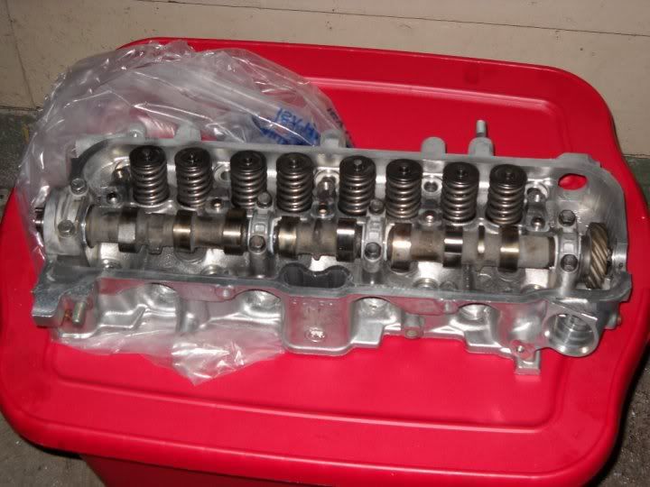

But there is good news -- I got the head back from the 'head shop' today.
They machined the gasket surface, trued the camshaft seats (not sure if this is the proper nomenclature), ground the valve seats and gave it a soothing bath. :lol:
While I had spent at least two hours scrubbing at the thing in a solvent tank, I felt my efforts were mostly wasted -- whatever they did cleared all of the discoloration and carbon build-up. It's absolutely beautiful.
It looks like I should have her up and running by the 13th.. I hope.. :|

Yes, they likely hot tanked it (heated chemical bath), it takes everything off, even old paint. Very toxic, all kinds of regulations on having one, wish I had one....sometimes they show up on craig's list, but much too large for a home shop.
It looks nice and clean. Since it is apart have you considered putting in a Delta Cams reground performance cam shaft. They are in Tacoma WA, only $60 exchange. They deal through the mail but you can drive there from Portland and pick it up in person in only a few hours (bring your core came to trade-in). It can be changed anytime since the cam is not too difficult to remove when the engine is in the car, but since you have all apart it would be a good time to install it now.
