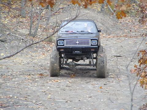

Not what traditionists would like, but I put mine on a Samurai frame. The body was rusted and I needed more support to offroad with. Stock engine and tranny, although I don't use the front driveshafts and go through the Samurai transfer case.
I do get looks and questions...You do not have the required permissions to view the files attached to this post.

You have avout 12" between the body and the frame. Looks like turd.
Re: offroad customization?
4 inch angle iron bolted to body and welded to frame, plan to cut out bottom frame. Funny, I call it "Terdzuki".. Thanks for the reply.

The biggest problem with tossing a frame under a car is, there is NO such thing as a matching frame. Wheel base isnt all that matters.
when I did my trar ( truck/car) I build the frame fromt he ground up to follow the unibody rails almost exaclt, I had .5 inch gap between the floor board and the frame. It was far from perfect but I built it when I was 16 with a welder, and a grinder.

I cant stand it when a car is simply belted/welded to a frame.
