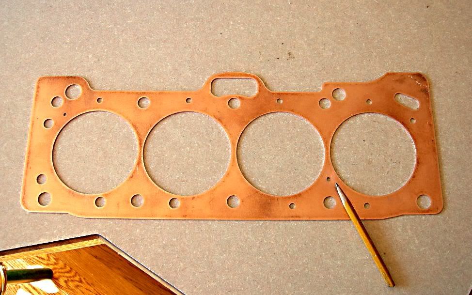

There is a simple head gasket modification I did to improve the water circulation (to improve the cooling) around the area where my head gaskets kept blowing out. I do not know if this has solved the problem yet, but so far so good. I have been having to replace the head gasket about once a year because of the head not cooling evenly around the exhaust valves, I am hopeful that adding a few more holes in the gasket in these areas to allow more water circulation to keep it cooler there, and keep the gasket from failing between the 1 and 2 cylinder (right in between the exhaust valves). I would do this mod on all 3AC rebuilds I do now, even a total stock one.
Do you just drill your own holes with a regular drill and bit? Can you show me where these holes should go? If it's going to increase the reliability or life span of the motor, I'm all for it.
Yes, just a normal drill, or a round punch. And then clean up the edge of the hole with an exatco knife. The holes go on the port side of the head between the 1 and 2 cylinder, and between cyl 3 and 4right where there is a water jacket port, about 1/4" dia. There is a thread in this forum where I have a picture of it on a copper head gasket I tried. I will find it and post it later when I am back in my office (I am at home snow bound and dial-up is just too slow!)

Below is the picture of where I placed the hole in the head gasket (the pencil is pointing at it), this is between the 1 and 2 cyl. I also put one between the 3 and 4 cyl in the same spot. I used 1/4 inch drill, a punch would work better since you need to clean up the edges with a drill on a conventional gasket. This is on a copper gasket, which I have since removed from the car (it needs a lot of trimming to make fit properly, I did not want to mess with it since I had to get my car running, so I just put in a fel-pro). But the location is the same.
