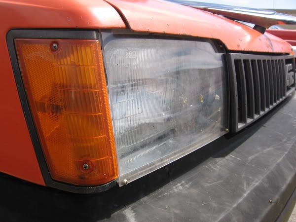

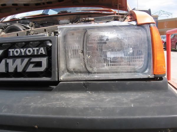

Had to replace both headlights recently so I decided to do the protective work I'd been thinking of doing for a while.
The old lights had holes in them from rocks and then they both went after driving in the rain.

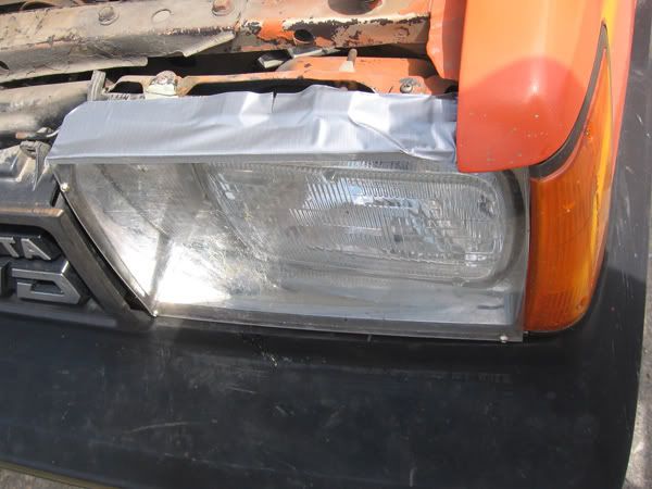

I used some 1/8 inch thick plexiglass. I have some 8x10 pieces and cut them down to about 6x10, pre drilled holes, 3 screws per pane, a bit of duct tape to keep out most of the rain and dirt and it was done.
Here are the pics

They look pretty good!
Obvious questions, I guess...
Does the lighting pattern seem diffused or compromised in any way?
I presume heat from the lamp is no prob?
While it seems unlikely you would attract legal attention (well, maybe your orange Tercabaker might, but most of us need not fear attention), are these legal? As I recall, the plastic covers are why the XKE became slightly less sleek with Fed rules.

Let us know how they work in the winter. I did something similar when I made a windshield deflector out of polycarbonate years ago. I found they worked great until we got a wet evening snow, then the snow stuck to the protector and made it like driving in the dark with no lights. :shock: . Needless to say, it came off soon thereafter since we do a great deal of night driving in the winter time. Nice Job though.

I will have to do a night drive and report back on any diffusion effects.
The snow report will have to wait. Here in the Canadian rockies that report could come any day tho. I just heard that there are only about 6 days of the year that have never seen snow in recorded history. I have experience wet snow gumming up the existing lights. We tend to get more of the dry stuff here so I'm not too worried. I'm also not too worried about legality in these parts. Alberta is fairly lax in that way. I know BC is more strict and I have been hassled by cops who do not like the state of the beaters I drive. They usually encourage me to get back to lawless Alberta.

I was finally out on an evening drive last night. Funny that it happened at the solstice when we have the longest daylight of the year.
No problems with the headlight beams or the brightness with the headlight covers.

I was thinking about doing this...if there's some opening at the top...any moisture will be evapped out with the heat from the light?
