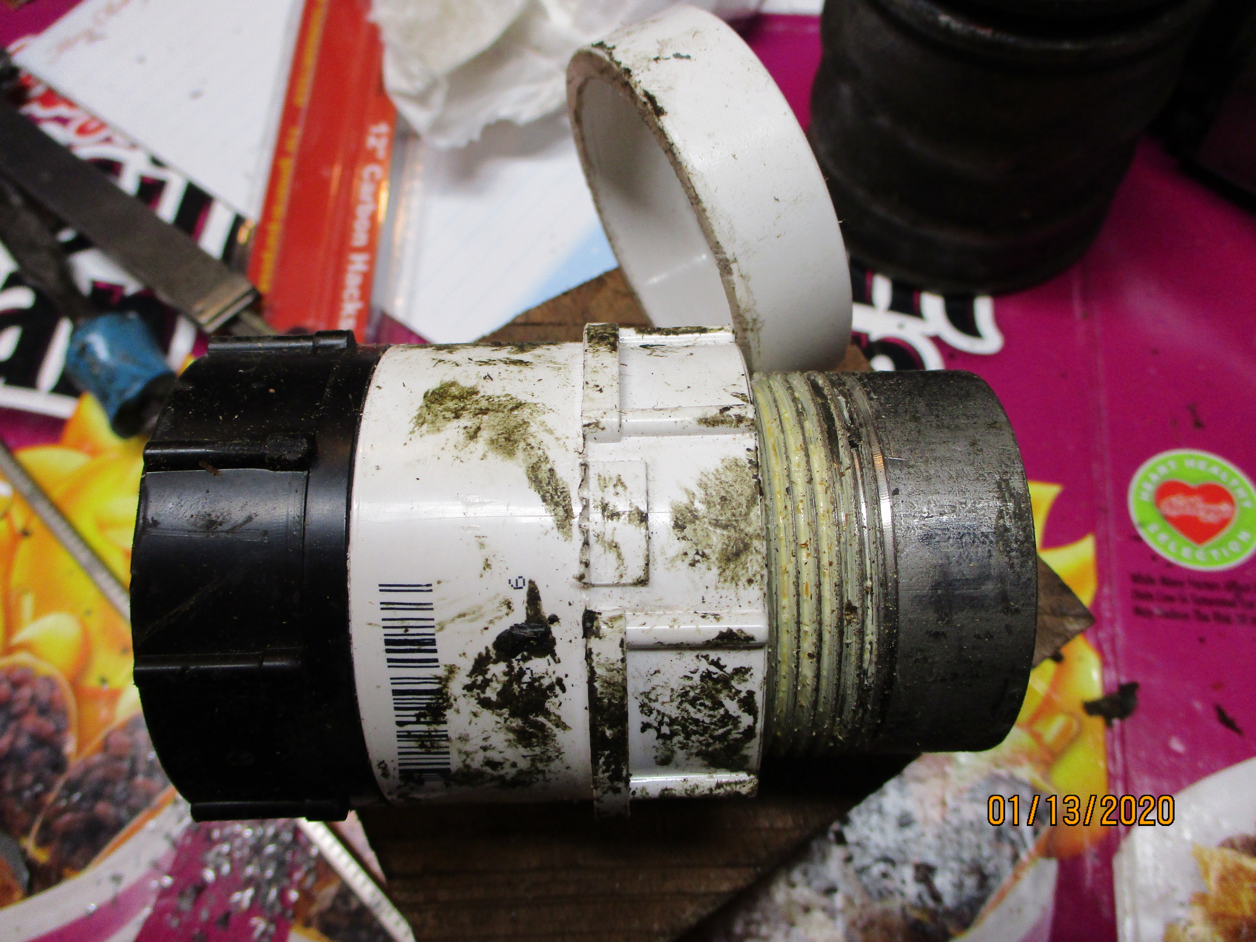

PVC or ABS pipe fittings for adjustable front axle seal installer

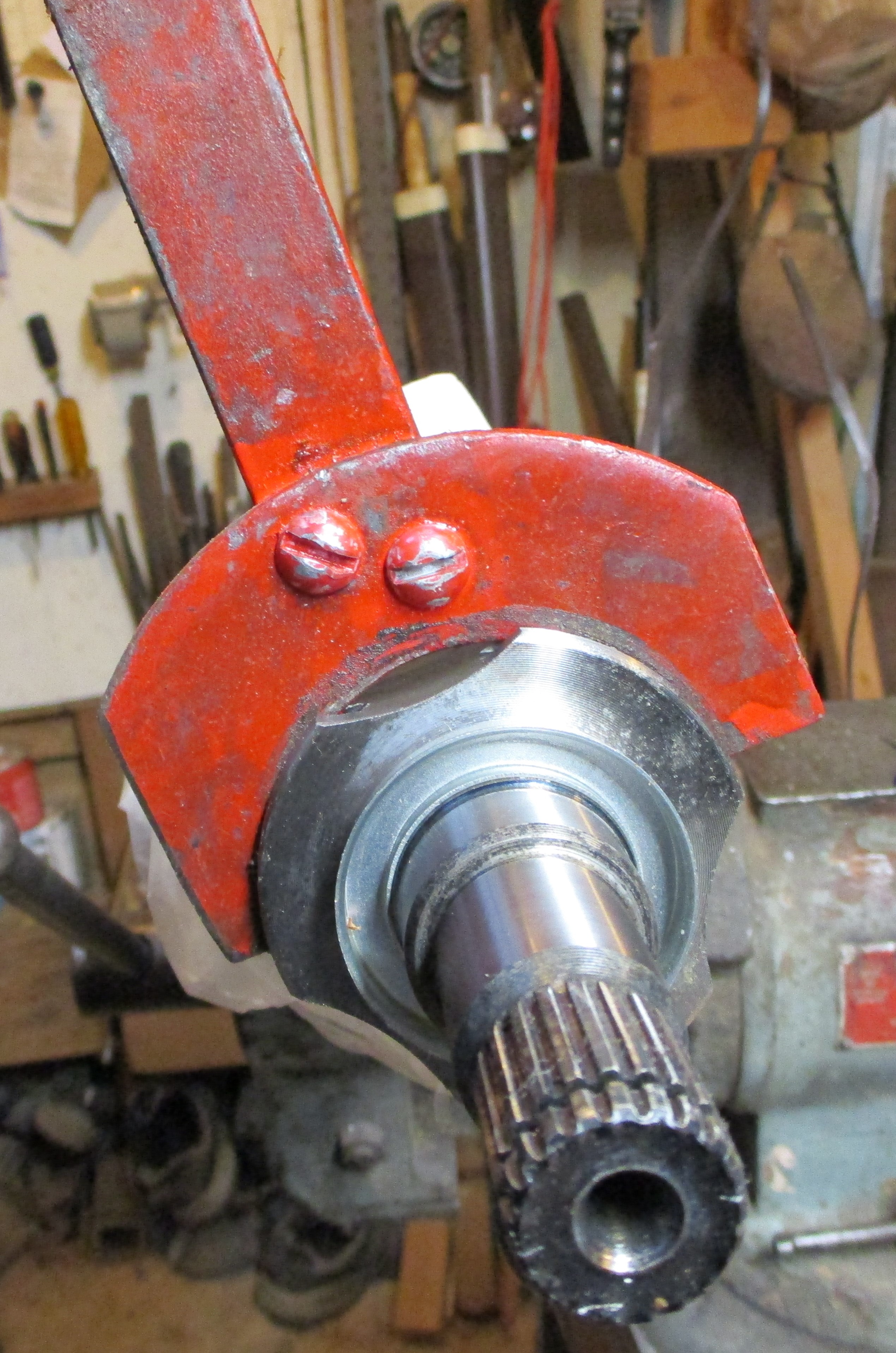

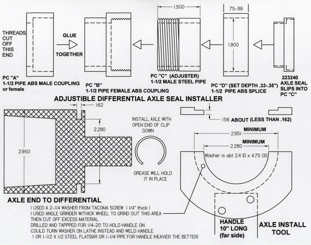

Hi Xirdneh, Do you think you could add photos of the tools you made as well as the drawings?
- Posts: 2124
Re: Front axle seal installer and axle installer (homemade)
seems like I included them in a youtube video but do not remember for sure
I will try to get pictures when I can and can get access to high speed internet
