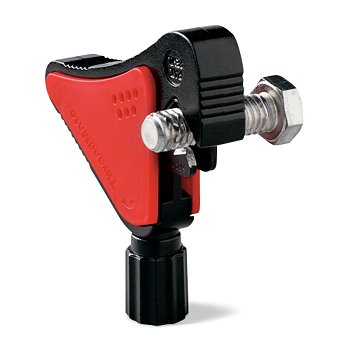

I found this while perusing Griot's. I've never seen one like this; it looks pretty handy since it starts from the inside threads. Pricey, at $35, but pretty cool - and it is adjustable to work on SAE as well.
VERY Clever Thread Restorer

The best bolts have rolled threads in the first place...not cut threads. Looks like it would work OK. I'd buy a new bolt if possible.
Re: VERY Clever Thread Restorer
it seems to me at that price you can buy a proper die set from Harbor Freight for doing proper thread restoration.
I think the idea here is that sometimes the ending threads on a bolt are too boogered for a die to get a proper purchase on the end of the bolt.

I have something very similar to that from WWII. It came with a German MG34 Cleaning kit. Mine only does 18mm to 54mm with a 1mm thread tooth and I've only used it for chasing steerer tubes on bicycles. Something smaller would be great for a 4x4 tool kit. I can't really see bringing a full die set but that tool could find a home for an emergency situation.

Your Snap-On tool dealer sells thread chasers (male and female) that are not so cumberson and bulkey to use and not that pricy. I have a set of SAE and metric -they look like a regular nut for bolts and a hex rod that has a tap on it for internal threads,bouth are a good investment in your tool box. Realy nice in close quarters.

Thread CUTTING dies are different from thread RESTORATION dies. Obviously both can work in a pinch, but there are differences.

The Professor wrote: Thu May 09, 2019 8:43 am Thread CUTTING dies are different from thread RESTORATION dies. Obviously both can work in a pinch, but there are differences.
Yes, I have heard this before, but when ever I ask at an auto parts store or a machine tool retailer, they do not know what I am talking about.
In an auto parts store they do sell these "thread chaser" tools, but they do not really have a cutting edge, and are made of relatively soft metal similar in hardness to the bolt. Like a regular nut with slots across the thread, same with the bolts. It works to clean gunk and carbon off the threads, but not clean up damage. If the threads are buggered up badly, it does not really clean them up or cut fresh surfaces very well.
