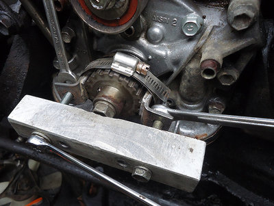

I have had troubles with a few Tercels trying to get the crank timing gear off.
On a few cars it was stuck on there pretty good.
After breaking one while trying to pry it off i began to heat them with a torch
That worked but I did not like doing it that way
I always try penetrating oil overnite first but that does not wok on the tough ones

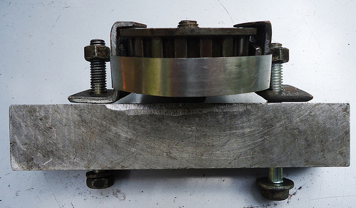

I made this tool and it worked great.

Re: Getting difficult crank timing gear off
Clever!

Re: Tool To Remove difficult crank timing gear
Awesome tool. I love to see everyone's creativity on this site. Good work! Next time I come across a seized pulley I'll make my own.
