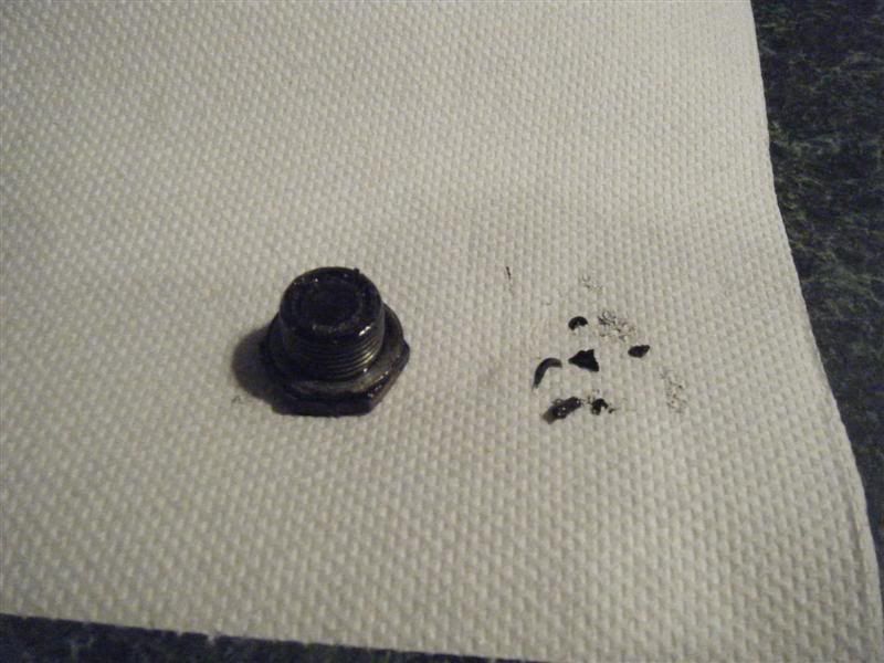

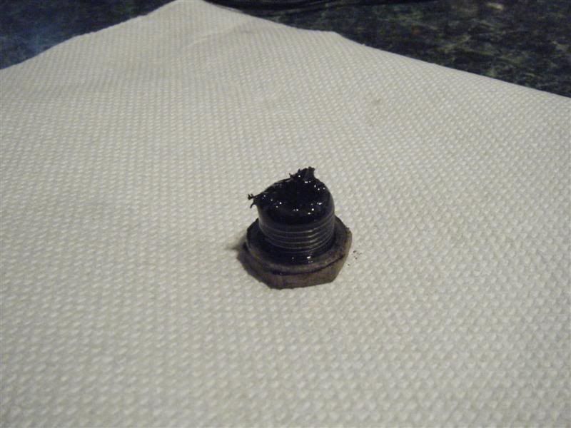

rotated the tires and drained/refilled the rear diff but the problem persists. i'm glad i did the diff though because i was surprised at the size of the chunks that were stuck to the plug magnet:
i pulled the biggest pieces off and wiped the gear oil away to show how big the shards are. might not look like much here but when you think about these guys floating around all the spinning gears, gouging and grinding and damaging everything, you realize that it was a good idea to change your diff oil.
i like your idea about putting it on stands to get a good listen, jarf. my wife will hate you for volunteering her to help me with this but i'm grateful.

looks like something is coming apart in the rear axle. If it is the bearing I suggest when you have the rear axle out, you drain the diff and flush a lot of solvent through the axle housing to drain it all out. Pour the solvent in through the axle end where the bearing failed, and allow it to drain into a pan under the diff housing. There is likely much more metal shavings in the axle housing. Than put the plug back in the housing, fill the whole axle housing with solvent, spin the rear diff round and than drain it out again.
Even with a new bearing you could trash the diff with that much metal floating around in the diff. Get as much of it out as possible now to save you grief later. IF you really want to be sure to clean out the axle housing, you can pull the other axle shaft out, and than pull the diff third member out of the center. Than you can clean the whole axle housing out from the large opening on the forward part of the diff housing. Than you can also wash and blow off the diff assembly itself. Not likely you need to go to that much trouble, but it would be the safest way to make sure all of the metal particles are cleaned out.

i carefully examined the drained diff oil looking for more chunks or grit but found nothing else, peter. that doesn't necessarily mean the diff is grit free and i agree it's probably a good idea to flush it but it appears that the worst of it was stuck to the magnet.Petros wrote:looks like something is coming apart in the rear axle. If it is the bearing I suggest when you have the rear axle out, you drain the diff and flush a lot of solvent through the axle housing to drain it all out. Pour the solvent in through the axle end where the bearing failed, and allow it to drain into a pan under the diff housing. There is likely much more metal shavings in the axle housing. Than put the plug back in the housing, fill the whole axle housing with solvent, spin the rear diff round and than drain it out again.
when you say to flush it with solvent, do you mean generic stuff called 'solvent' that i can get at any hardware store or is there anything in particular i should use?
