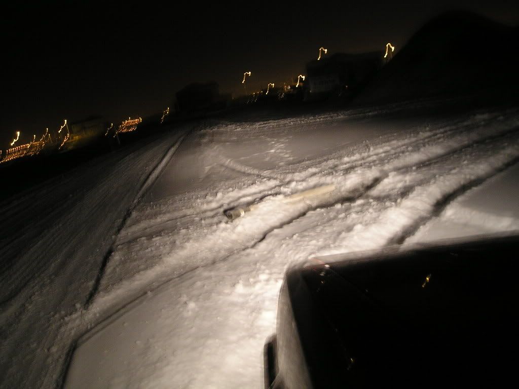

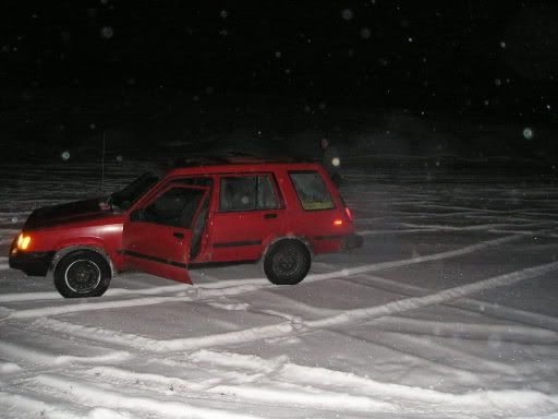

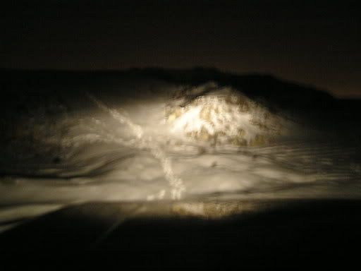

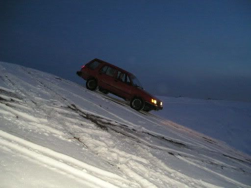

i figured it was about time i have not been too active on the site because i've been spending lots of time on another forum for my motorcycle, i'm going to the yukon in the summer on my klr650 and i've been doing some research and stuff but here is a couple of pics i took yesterday, the ones at night were after the NHL hockey game the Flames won!

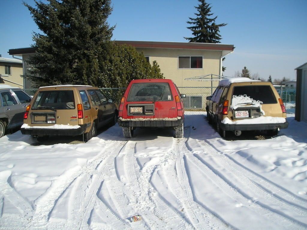

a pic of the crew just bought the left one for my dad but it's not in use yet

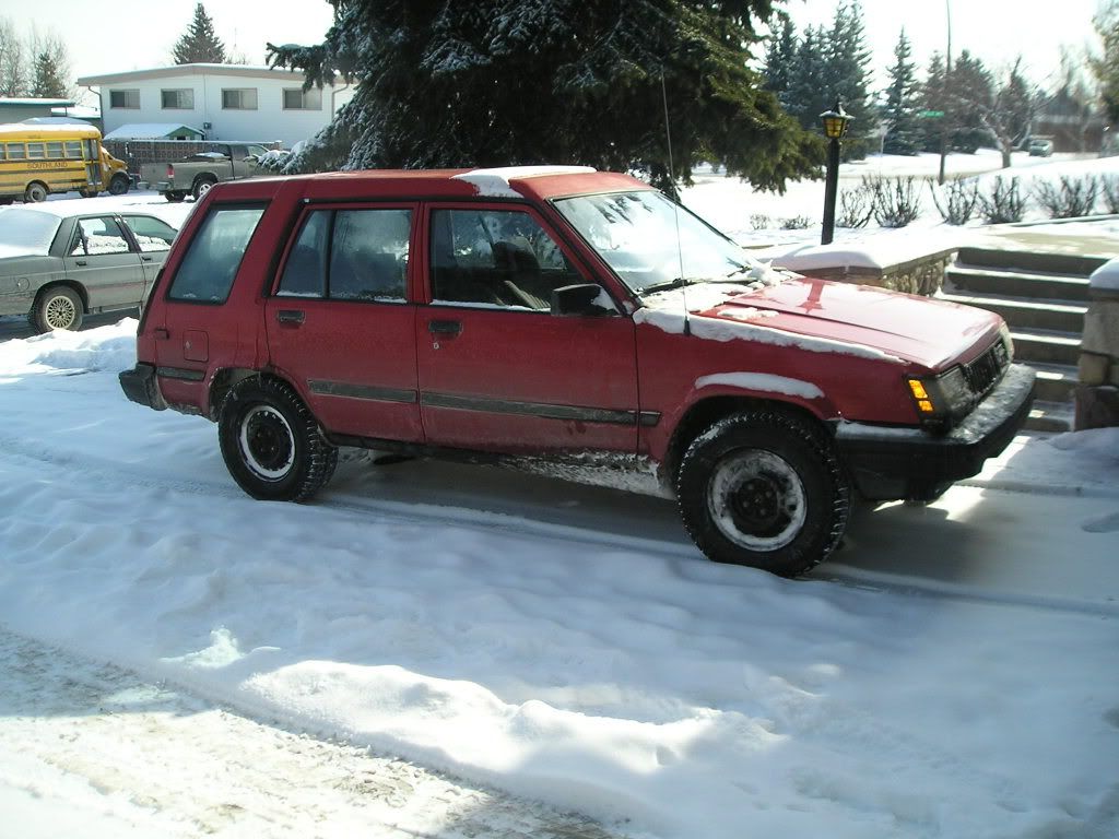

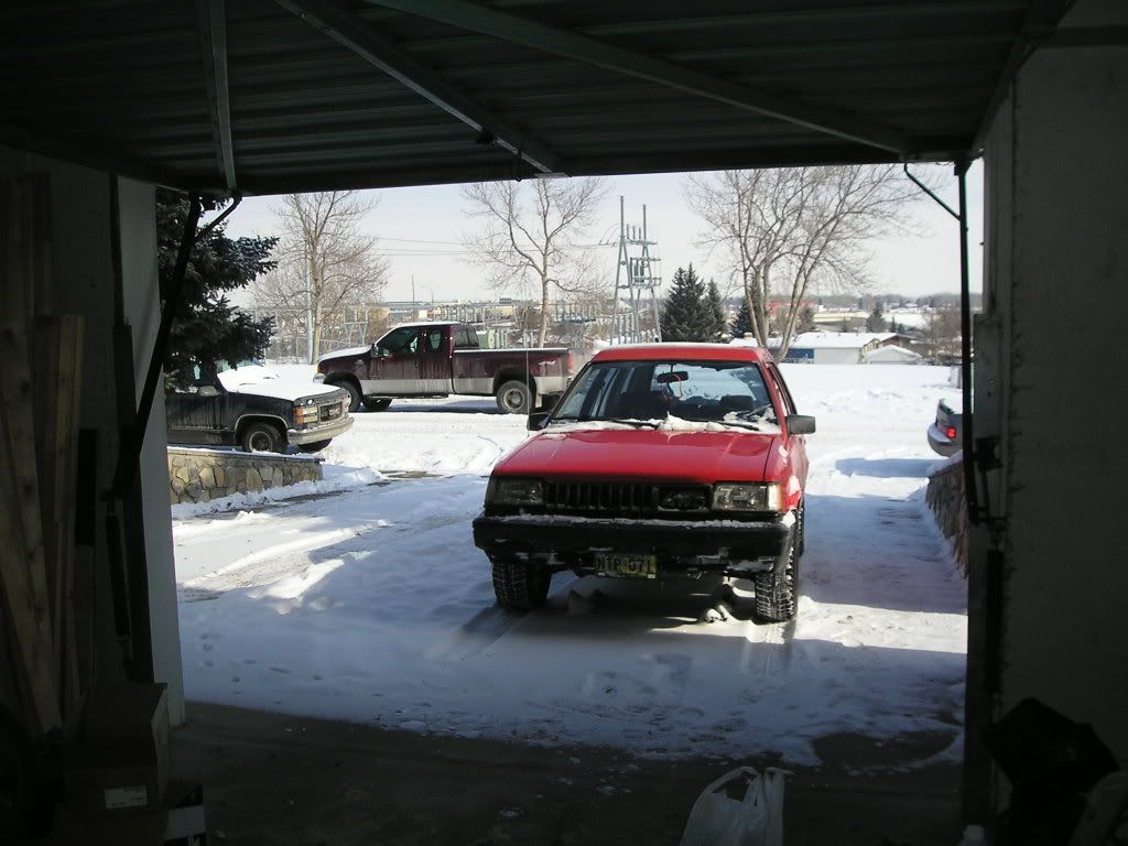

the beast in front of my house it's been a mild winter

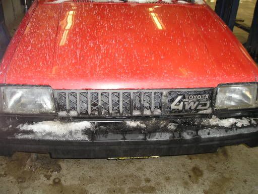

my 83 grille conversion looks badass!

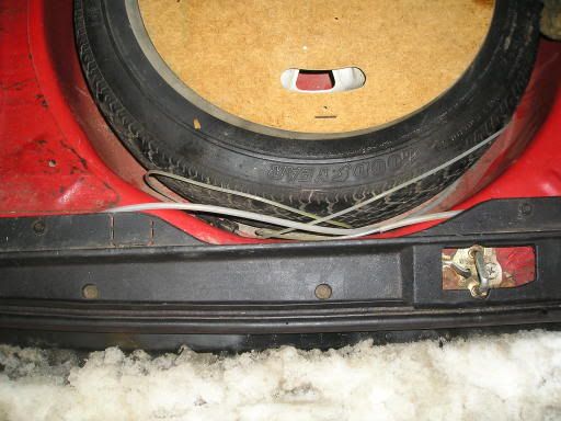

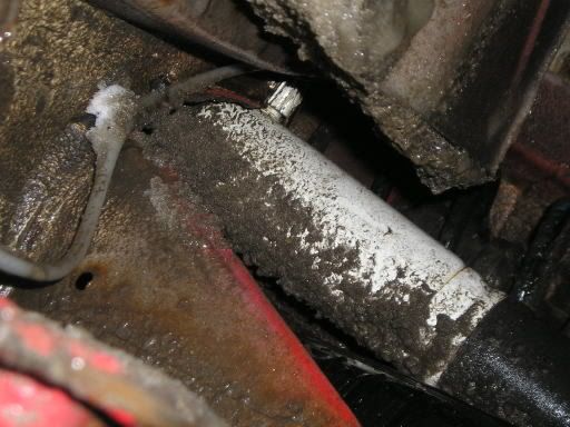

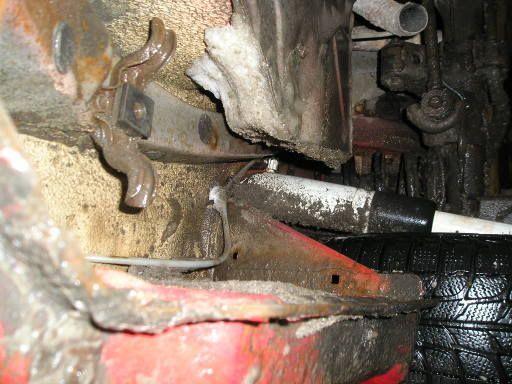

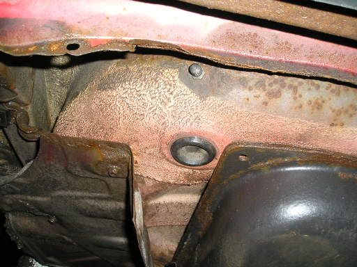

i decided to finally decided to turn my monroe air shocks inside, after the 4th time of blowing a line and riding home on my springs. here are some pics of the finished product, i cut out some of the unibody to make them fit(but no supporting
parts, just a little )

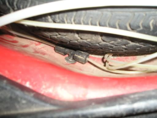

here are the airlines which i put inside some small pluming plastic tubing to protect them from gettiing squished and torn

Hope you have better luck with the air lines now. Were they leaking from getting bumped or something?

What size tires are on your red 1987 or 1988 Toyota Tercel DLX 4wd 5DOOR Wagon? Are they what by 14"? What size are they and what is the brand and model? They look mad sick on your Terc! Keep up the slick work!!!!
yes i did lift her after all with the help of simon 84 we used his rubber doughnut technique in the front, but im going to have some spacers made like the ones dirtmagnet has in the front
the tires are 205/70r14 and they are michelin x-ice winter tires
they work very good
That one solution to the Monroe MA700 problem. I ended up with 2 doughnuts in the rear springs and no air. The longer Monroes help some crossing gullys and washes.
