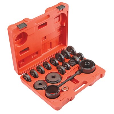

I wanted to replace the drivers side front hub bearing on my car and was left with the option of buying a press ($$$) or paying someone at a shop to press the bearing out of my knuckle for me. After calling around, the best price I got was $75 (!!!!).
I saw this bearing press set at Harbor Freight while picking up a strut spring compressor and decided to give it a shot.
http://www.harborfreight.com/fwd-front- ... 20provided
Works great! the basic premise is you have an adaptor that sits against the outer race of the bearing and a large cup that goes on the other side. A large bolt goes through the middle and by tightening the bolt it presses the bearing out or in depending on how you have it configured. The only thing it doesn't have a provision for is pressing out the hub itself but that knocked out fine with a socket and a hammer.
It was a little more than paying the mechanic to press it out but if I ever have to do the other side (or any other car for that matter) it will have paid for itself. Plus, it allowed me to buy more tools so there's a win right there :D
instructions said to use an impact wrench but I wanted to try with a breaker bar first since I didn't have an impact socket of the correct size and didn't want to chance blowing up my regular socket if it was really tight. I used my torch to heat up the knuckle first and it pressed out like butter! Super easy.
Anyway, nice alternative to a press for anyone needing to do this job in the future. I wouldn't be surprised if you could get a rental version from Autozone or a Pep Boys.

I have something that looks similar but instead of the mandrel and threaded rod it has a big steel striking handle. You hold it in place and whack the end with a small sledge hammer to drive out the bearing. I bought it at a garage sale for $5. it comes with several handles/anvils, and a lot of different size and shape of cups or driving tools, I have used them to drive seals too, using light tapes with a soft hammer. works well for removing old bearings, seals and races, but you have to be very careful using it to align it properly before you strike it or you can mare up the lip of the bore. The screw-in mandrel is easier to hold it in line and apply slow pressure to get it into place vs. the one I have.
