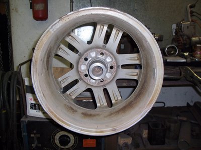

had a lot of people ask me to straighten their bent rims for them, put this together and it works really well. little heat and a little jacking, can get them back 90% sometimes better depending on the make of rim.

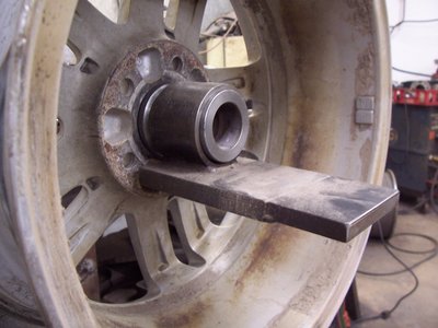

Very impressive. How is it mounted in the hub?

the large shaft you see stickin out has tapered collars on both sides like a wheel balancer, then it steps down to 1-1/2 shaft that goes through 2 bearings with a 1"nc thread to pull it up tight and lets you spin the wheel

Where did you get the parts to make it?

i own a machine shop so just stuff i had kicking around

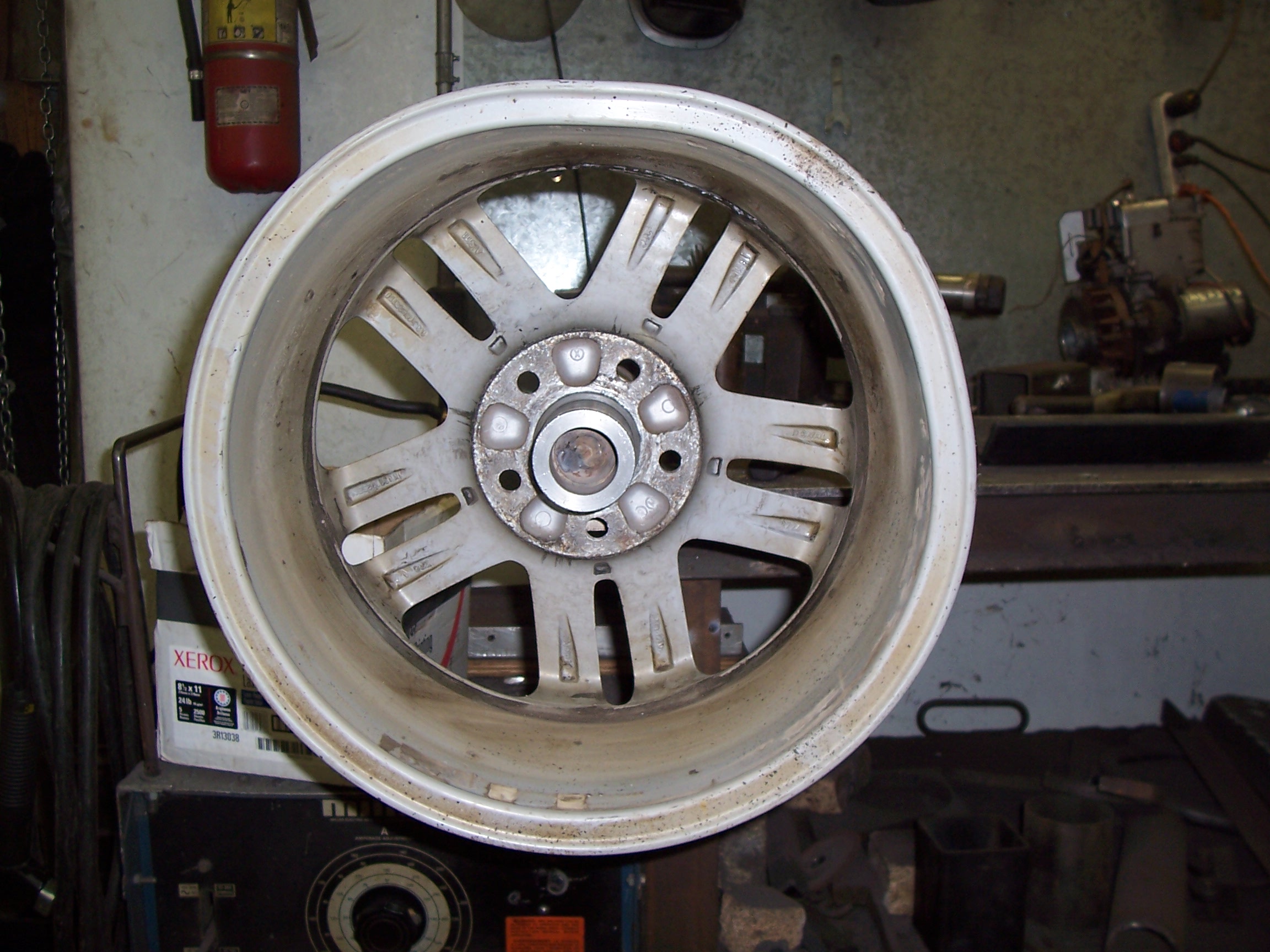

most of the time takes 20-25 mins to do one
