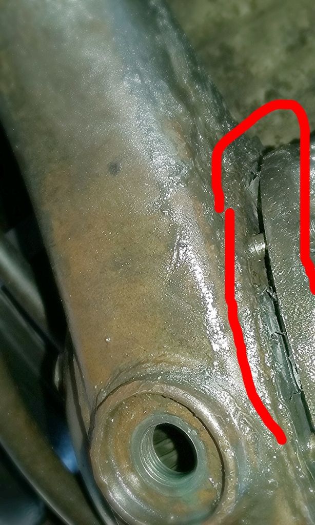

Ok well it wouldn't be normal if there was nothing wrong with this graceful chariot of neediness
So here's the new deal .after AL the above work the rear diff leaked .so I drained the blood and Un did the fLange (4 bolts on drive line) undid the 9or spb12mm nuts and wiggled it right off . Cleaned it up put a new gasket and it still leaked .so here I am now EXCEPT this time the removable part of rear diff will not come out .I feels like it's on a really tight spring .any idears

Did you remove the axles?

Re: Clicking noise when i 3rd and 4th gear and...
Post by gnarnold »
No I didn't have to last time I gasket a go -goedImage

Post by Gottolovem »
gnarnold wrote:No I didn't have to last time I gasket a go -goed
WRONG you DID have to.
At the risk of sounding like an a** hole you didn't do the job right the first time and now your doing it again!
Pull the axles so you can pull the diff ALL the way out then clean it right glue it right and be done with it. :oldgeek:
