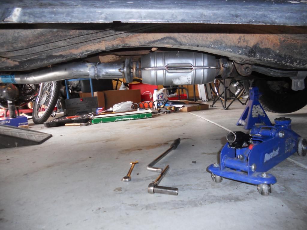

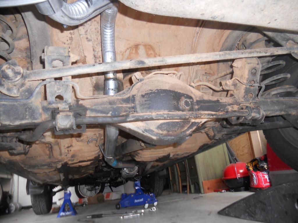

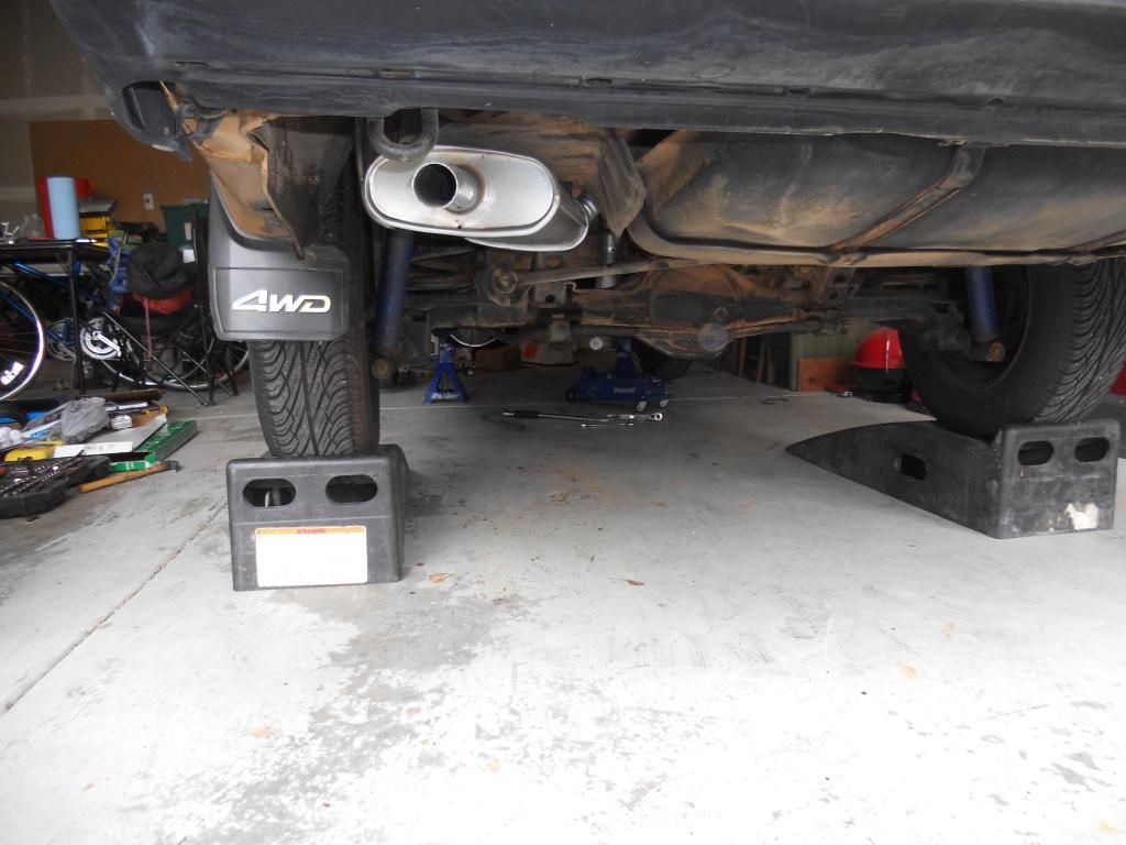

I finished the exhaust today this marks the first time in my vehicle history that I have ever had a complete exhaust system. I had to shorten the tail pipe 4" to fit the catalytic converter. I think the tail pipe came from a model that did not use a cat, thus longer. I only had to make two cuts and a weld. I'd say not bad.
Here's some shots.
I've got about two fingers between the cat and body :/ but it actually tucks up nicely. Looks like I lost a couple of the rubber donuts towing it home. whoooops.
Here's some shots.
