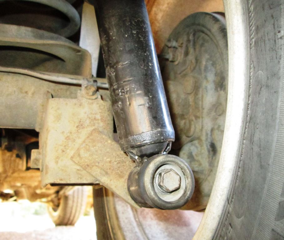

I put air shocks on my '84 a week ago. They are the Monroe version of the Gabriel shocks mentioned early (fit Ford E-150 van or something).
They fit a little too close, I should have tried to hammer the flange away from the shocks. They don't seem to rub unless driving over uneven land. Perhaps the Gabriel shocks are thinner and leave more room.
The airline fitting runs close to the body flange, but does not touch.
I was able to press out the steel sleeve through the lower bushing with a bench vise. I then pressed the rubber bushing over the original Toyota lower mount using a series of different length bolts and spacers and some rubber lube.
Thanks for the idea!

how do you like the air shocks so far, shawn? where does the air line run to?
