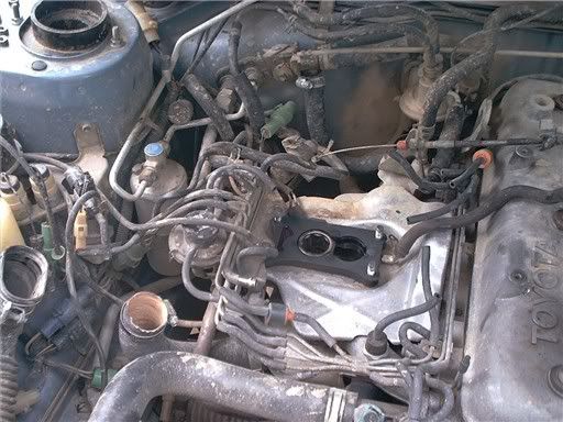

if you look at this photo from the weber install thread, you can see the hose that runs from the PCV valve to a port at the base of the carb:

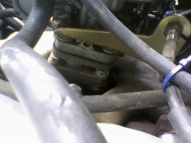

i don't have a port at the base of my weber though. the nearest i can see there is what appears to be a brass-coloured plug in approximately the same area. you can just see it here, below the brass arm:

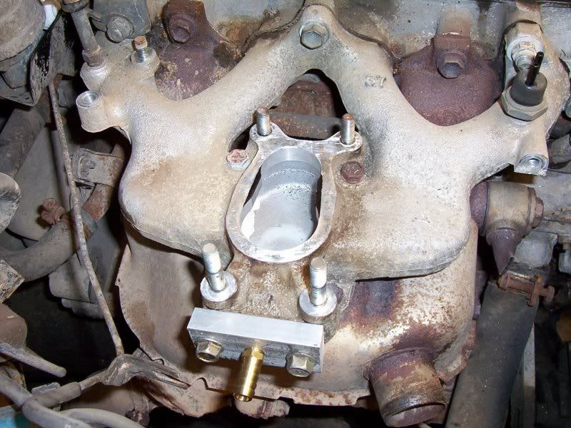

is there some way to connect to this port that i'm unaware of? or should i remove the EGR (which is disconnected anyway) and make up something like splatterdog did to connect the PCV outlet hose to:
also of note is that i don't have that metal plate that sits underneath the carb (the big shiny silver piece seen in the first photo) installed. is that a heat shield to protect the carb from the heat of the exhaust manifold? should i put it on? i don't know why my bud didn't put it back on when he installed the weber.

I would definitely keep the heat shield. The other device where the hose plugs in is an insulator with the heater element on the primary, the heater is not required unless you live in an area where it gets really cold, it prevents ice build-up under the throttle plate. Without it you take your chances of getting icing under the carb before the exhaust manifold heats up the intake. Not a big problem, just a cold run nuisance. The car will have more power without the heater element since it restricts the size of the primary barrel.
I suspect you can find any port into the intake manifold to install the vac line for the PVC.

my dad is making a copy of splatterdog's EGR to PCV conversion plate as we speak!...
now what i'm wondering in regards to my missing heat shield: since the pinging problem is happening after the engine has warmed up, could it be that the heat from the exhaust manifold is rising up to the carb and heating both the gas and the air there, before both even enter the intake manifold? danzo's comment about a heated intake charge causing predetonation got me thinking about that, though i don't know if the heat would really make too much difference to the carb. it must though, if it's designed to operate with a heat shield there. my dad mentioned that he has heard of gas in carb floats boiling from similar circumstances but i'm not sure that this would create predetonation either.

I do not think the lack of heat shield would cause that except in very hot conditions, in heavy trafic or up steep slow grades. IT is possible that if you do not have that plastic base plate the carb will heat up through the manifold. Consider the intake manifold is bolted right to the exhaust manifold, and the carb bolted to the intake manifold right above it. It will heat up through conduction. Even fuel injectors in the modern engines have these plastic insulators on them.
There is a reason there is a plastic insulator plate under the carb. You might make one to fit the Weber out of suitable high temp plastic. Phenolic or perhaps some high density polyethylene, or acrylic perhaps; you need something that can take the heat of the engine. you could test it with a piece of plywood, but I would not leave that in place for long. You can reinstall the heat shield when you get the insulator installed.

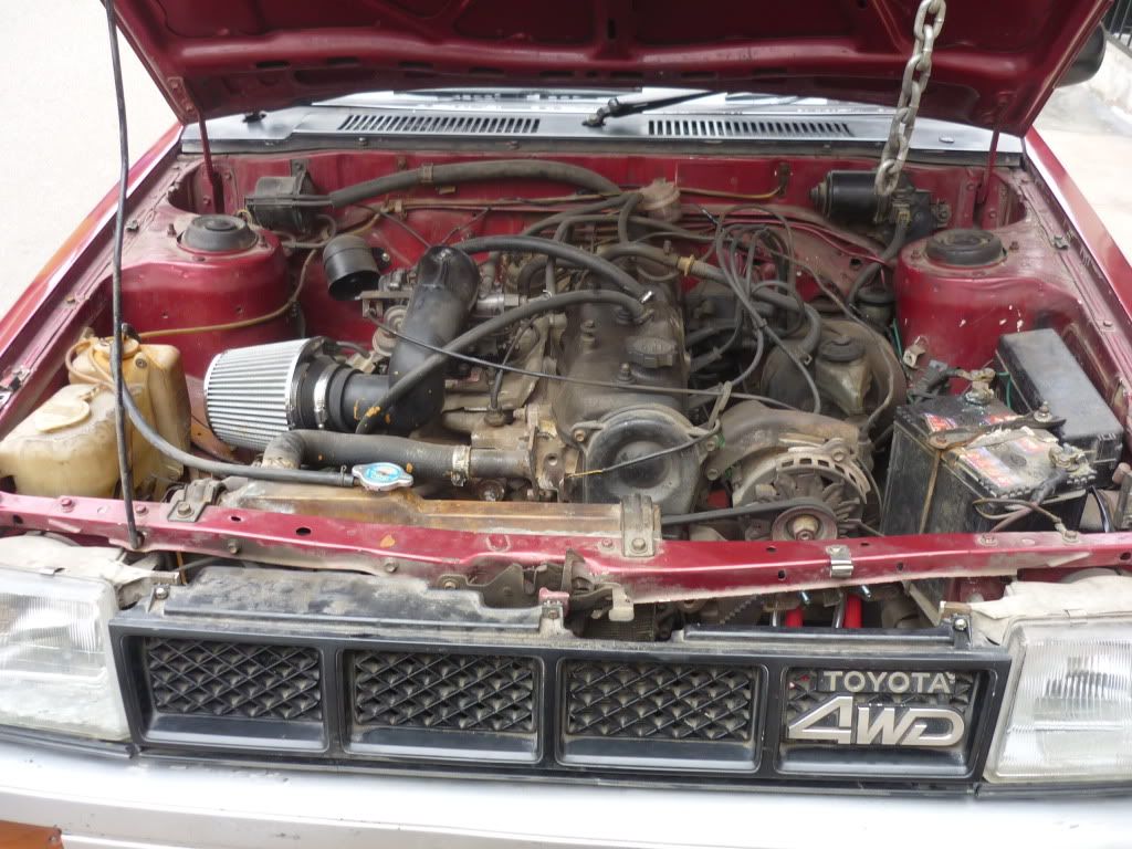

it's been a while but i've made some progress in this department. i was having some pinging occur when under load ever since i had put the weber on my 3A. i had hoped that when i switched to the 4A that this problem would disappear. it did not, so it appeared likely the problem was not with the engine but somehow related to modifications made in relation to the weber. i had seafoam'd the combustion chambers, checked for vacuum leaks, retarded my timing back to stock 5* BTDC, tried cooler heat range spark plugs, got my PCV system set up properly, wired the heat control valve on the intake manifold to never warm the intake air, disconnected the vacuum advance, made the fuel mixture richer, and reinstalled the heat shield that normally sits beneath the spacer. none of this stopped the predetonation. i never bothered trying high octane gas because buying even MORE expensive gas is not an option and didn't seem like it would help me diagnose anything. when my friend helped me install the weber we never put the shield or spacer in because of concern over hood clearance so the spacer was the last thing i wanted to try but i finally did and i had interesting results.
the engine ran considerably cooler according to the gauge, and the predetonation was gone. first i drove with no air filter on the weber so that i could close the hood. i drove like this for maybe 40 km. this yielded the cooler/no pinging result, so i put the filter back on and had to leave the hood only partially latched and fastened with bungee cords in order to drive it around. i drove it like this for at least 150 km and this yielded the same result, which was great news but now i'm left with having to deal with the hood clearance issue. like tom, i replaced the engine mounts when i put in the 4A last year, and also like tom, i need at least 3/8" more clearance to close the hood, though 1/2" would be ideal. i don't like the idea of shortening the weber air filter (it's the 2" one already) because that lowers the lid for the filter towards the intake throat, making it more difficult for the air to squeeze in there. i know tom has reported no problems with this but i'm looking at alternatives anyway. i'm considering getting another hood and installing a hood scoop but i am also talking to K&N about either a low profile filter or low profile adapter so that the filter would sit in the space between the engine and the passenger side of the engine bay. sort of like what board member pearson has:
