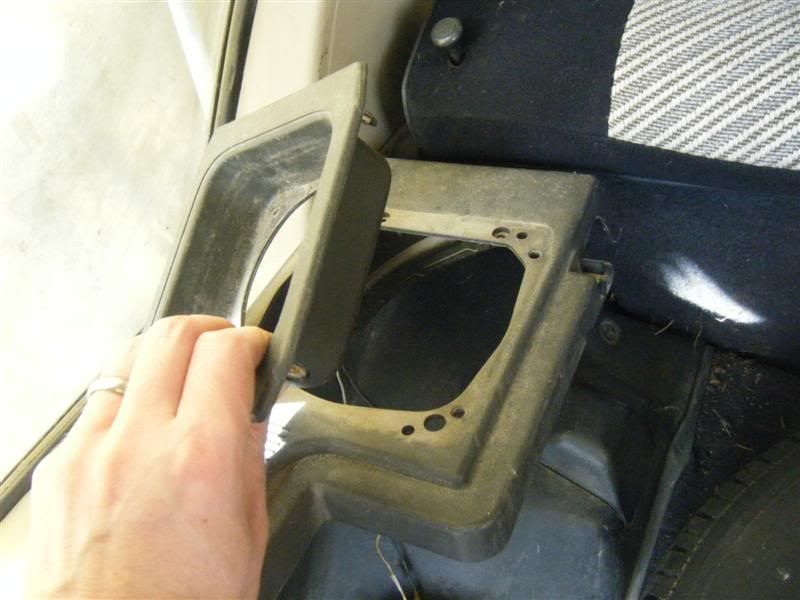

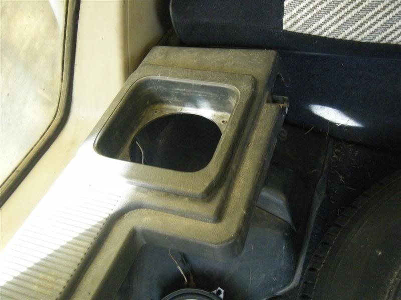

just noticed this while messing around in the back of the project car. the wings/shelves in the back appear to fit EITHER 4" or 6.5" speakers. i found that the tray that the 4" speakers sat in could be popped out, exposing a bigger speaker hole and multiple mounting holes.
here it is with the 4" speaker tray:
and here it is with the 4" speaker tray removed:
i didn't have any spare 6.5" speakers sitting around but i measured and compared the mounting holes with the 6.5"s in the back of my car and they appear to match. if i find some cheap ones i'll try throwing them in.
