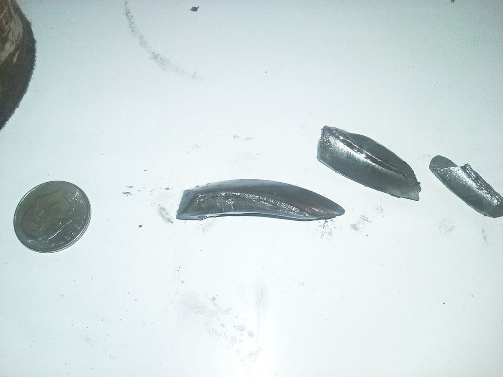

Got it apart this is what fell out of gear oil drain hole

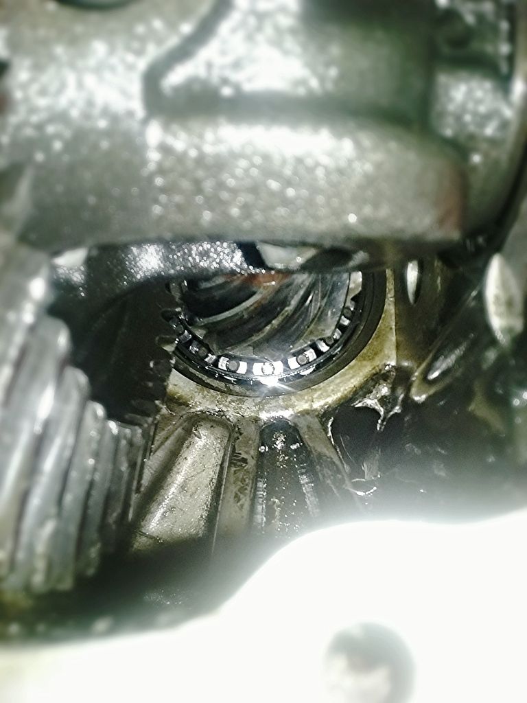

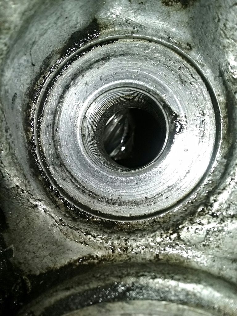

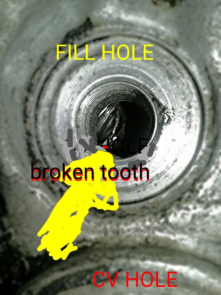

I think tranny itself is fine ..do I go ahead and take the front cover / plate of transcaxle .because as I peered through the cv fill hole this is what i found
There are broken teeth on that gear .can I replace that one gear .
I think that is the cv input hole .anyways it seems to shift fine without the transaxle on as I picked up the transaxle though I could hear more metal jingling around in there could it be that this is a problem isolated only to the transaxle?......oh please oh please .

Sounds to me like you can replace just the bellhousing/diff section of the transaxle
That's good news for you pull the front cover and count the teeth on the really big gear it's called the ring gear and count the gear way in the back that turns the ring gear it's called the pinion gear. Take the two numbers and divide them that confirms the gear ratio.
Report back their is a small chance I will have one.
Some ring gears have a stamp on them telling gear ratio
You will need to use nail polish or some type of paint to "mark one of the teeth" to help you count the back gear.
Good luck
Good luck

also use a magnet on a stick to get all the metal out of tranny

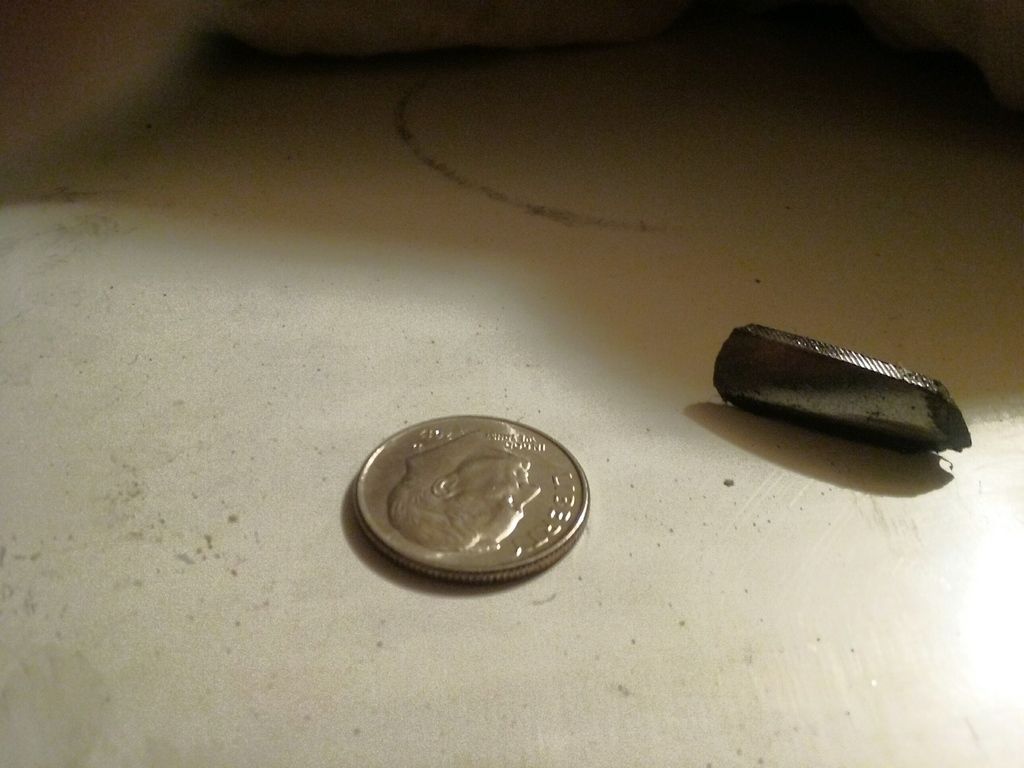

Here's what came out of transaxle case
Here's
the gears look like
The big one spins the teeth don't touch hardly at all count on teeth is 41 big gear 10 little back Gear which has about three broken teeth
Here's
