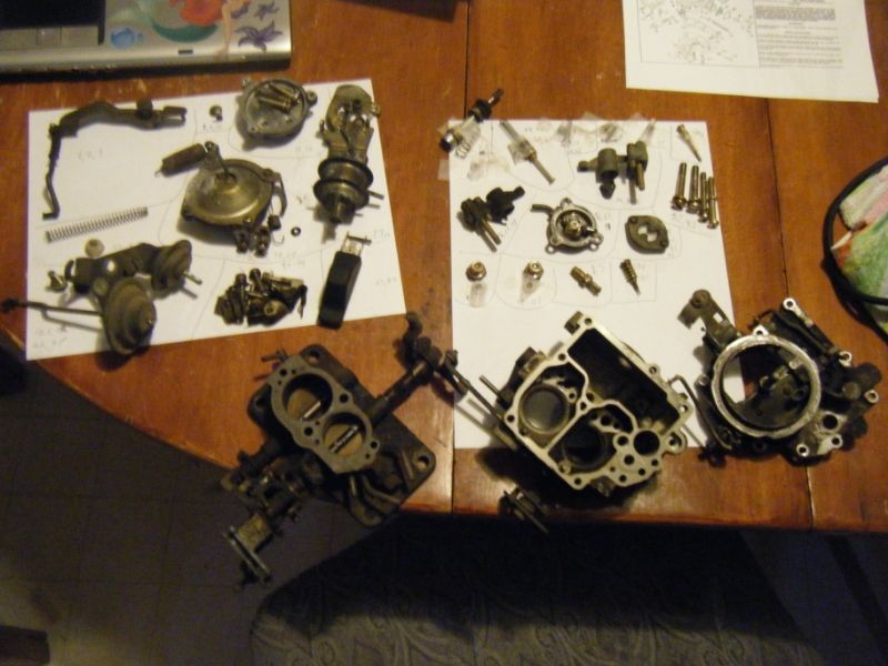

slowly but surely, marlene. after playing with the carb i found that the fuel level was really inconsistent--sometimes at the low end of ok, sometimes way up above the glass, and i couldn't figure out a pattern to it so i decided to go ahead and rebuild the carb. however, once i removed the carb from the car i noticed some differences in the vacuum ports between it and the stock carb. it is still basically the same carb but it looks like it came from an automatic and has a few extra vac ports. a few of the ports have really small holes instead of the normal size, like the HAC port on the US cars vac advance cans. those smaller vac passages on the carb were on the ports going to the choke breaker diaphragm B and lower vac advance diaphragm. i'm not sure how it would affect those things but it seems like the restricted vac passages may not supply enough vac for the devices to work properly (although the choke breaker B has a 'jet' between it and the vac source which would essentially do the same thing) so i decided to keep things as stock as possible and rebuild my parts carb since it is the correct version of carb for this car, and take the few needed parts from the other one. i can't remember what was wrong with this carb except that the car ran like crap and died sometimes.

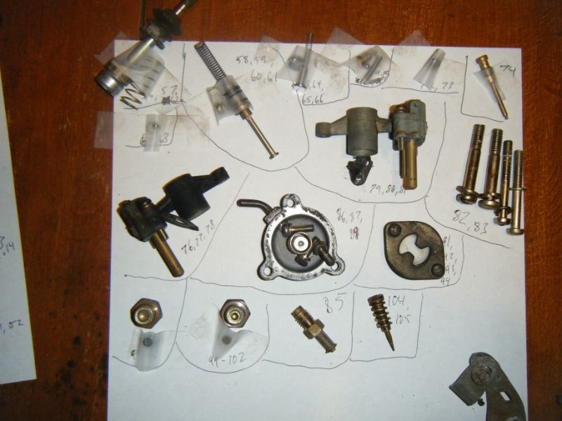

i got a rebuild kit and the parts were right but the instructions were for some carb i never heard of, a rochester or something. looks like it came on a bunch of pontiac stuff. i wound up going to BWD's website and got the correct instructions and took the aisin apart yesterday. i put all the parts on a few pieces of paper and numbered the parts according to the instructions. the bearings and springs and jets from the bowl are so tiny and easy to lose so i taped them all down to the paper.
close up of my high tech approach to keeping organized.
