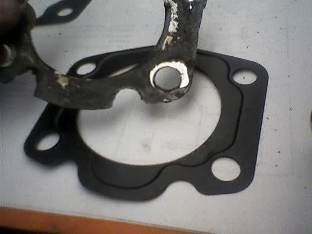

i rode in the cargo area while my wife drove the car around the block (much to her annoyance) and the sound was definitely coming from the passenger side so i ordered the bearing, gaskets, retainer, and oil seal. i've got it all apart now and will be taking the axle shaft, new bearing, and inner retainer to a machine shop tomorrow but i'm confused about which way the axle housing to backing plate gasket is supposed to face. the old gasket is completely flat but the new one has a raised portion on it. i took a photo of the new and old for comparison:
when i look at the drain hole system (which i'll get into in a second), it looks like the raised portion of the gasket should face toward the brake backing plate, but both the backing plate and axle housing are flat so it seems the gasket will end up crushed and deformed once everything is bolted up, which would be bad.
second part: can someone clearly explain how the backing plate drain holes work? i read this thread
https://tercel4wd.com/forums/viewtopic.php? ... 78&p=22409
and that helped a bit but i still need clarification. it seems that water somehow gets inside the outer retainer (i'm not sure how but it doesn't really matter) and that it leaks out the drain holes. the two gaskets have notches in them to accommodate this draining: the outer gasket is cut out at the top, allowing water to move through hole in the brake backing plate, and the inner gasket is cut out at the bottom, allowing water to drain down and out from the backing plate through the cut outs in the axle housing. is my understanding of this correct?

I put the raised portion inside the bearing outer retainer - that seemed correct - apparently has worked OK for 1 1/2 years.
I think your analysis of the water exit is correct. I never figgered out how it got in there in the first place...
https://tercel4wd.com/forums/viewtopic.php? ... ket#p42553

yeah, the outer retainer to backing plate gasket makes sense to me. it's the other gasket between the axle housing and backing plate that has me confused. you didn't run into this problem with it, tom?

the hole in the center of the retainer plate is larger than the axle
thats where the water gets in

thank you! while you're here xirdneh, any input on which way the axle housing to backing plate gasket should face?xirdneh wrote:the hole in the center of the retainer plate is larger than the axle
not sure what you mean, LB. are you suggesting looking at a manual for an early 80's corolla? if so, the gasket design has changed since the manuals were made so they don't make any mention of this raised style of gasket.

i do not know about the gasket
i have never replaced one
usually i do not mess with them at all
but when i do i just slap some gasket goo on the old ones and re-use them

yeah, the old one is in ok shape so i can reuse it and hang on to the new one until this mystery is solved. i just really want to use the new one because it was expensive ($14!) and non-returnable.

took the shaft, bearing, and retainers to the local garage to have them press them on. i also brought the gaskets and asked the mechanic what he thought. he said it would flatten out once everything was torqued up. i don't agree with this but figured screw it, if everyone else has been putting the new gaskets on whatever way they please and not having problems, i won't worry about it any further. i'll post if i find any troubles down the road.
and it was indeed the axle bearing. finished the job yesterday, took reggie for a test drive today, sounded great. thanks to all for the help.
