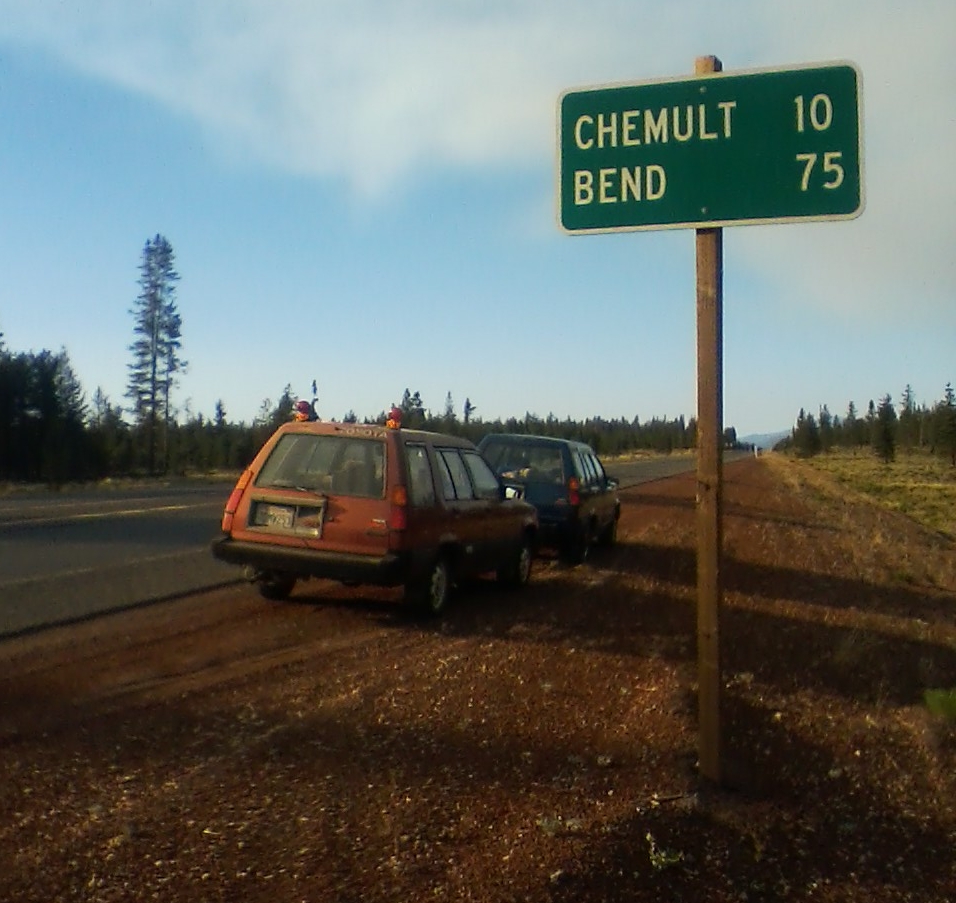

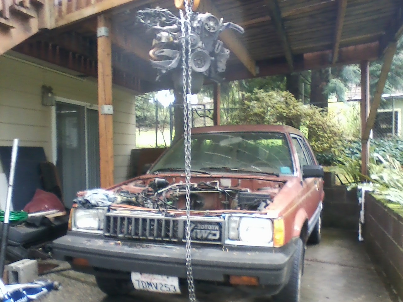

Pictures of new acquisition, needs engine.
A nice find, very straight, very little rust,
cloth plaid interior not torn or badly stained,
power steer and a/c equipped.
Speedy Blue doing heavy lifting, 275 mile tow, Prospect to Portland

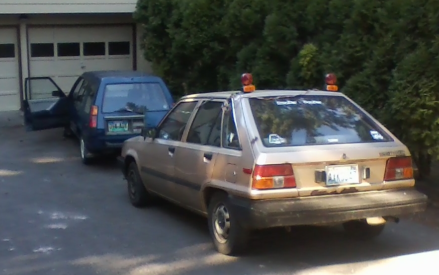

Picked up the '83 hatchback donor car with an oddball 3A-H engine.
Also comes with a brand new stock carburetor, calipers, and catalytic.
Feel bad for previous owner doing all that only to fail and give up on this hatchback.
It runs barely, weak compression and loud tapping,
hoping its just in the head and valves.
Will redo head in place, and put 3AH in T4 from Prospect if it works.

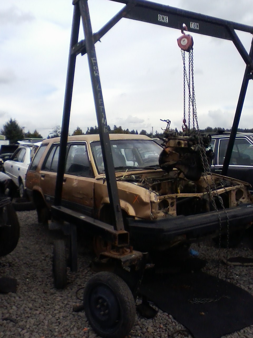

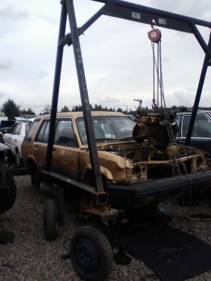

With the rocker arms removed (someone already took them) and all valves closed,
manual turning resulted in a good even compression feel, so I took it.
Dropping in a good engine.
