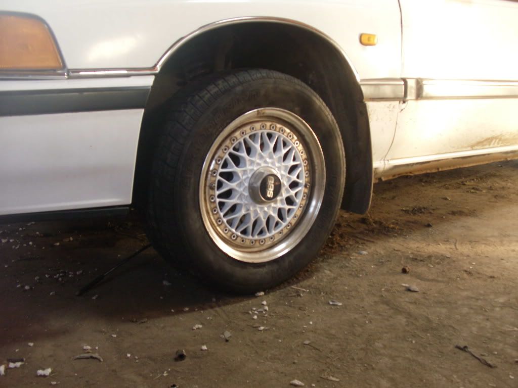

I just got done painting the BBS rims on my Legend. I was going to paint them back the original gold, but I wanted to test them with white paint to see how they looked. It was a bit easier for me though, as the wheels are 3 piece so I was able to take them apart and paint only what I wanted to paint.
Don't mine the wheel gap, this was before I completely put the wheel together and aired up the tire, the car is on a jack in this pic.
They make wheel paint that is for higher temperature and will hold up nicely to rock chips and such. It's by Dupli-Color and is sold at O'reillys and most likely about any auto parts store. I used it on my Integra, and they came out quite nice. They make primer, paint, and clear coat specifically designed for use on wheels.
Sorry I don't have any close ups of the wheels.
