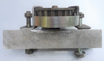

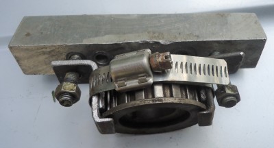

Lower Timing Gear Removal Tool
Post by xirdneh »
get the timing gear off much less chance of breaking it

Re: Lower Timing Gear Removal Tool
Post by garyfish »
brilliant!
did you scavenge the jaws from an old puller?
Post by xirdneh »
no, just bent some 1/16" (.062) or 3/32" (.078) thick steel
