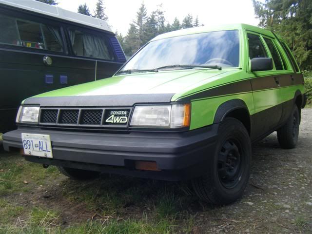

so i FINALLY got ron all painted. it was no cake walk because there were a few complications along the way. i gave the store a paint chip for the exact green i wanted but the green i got wound up being a little bit lighter. not a huge deal because it's still an awesome green but boy oh boy, if i had been dead set on a specific shade i would have been some pissed. then the day after my buddy painted the chip guard it had bubbled up in some areas but not others. he chipped it all off and did it again and it seems to have stuck fine this time. he said he's painted numerous vehicles with chip guard and never had it happen so i asked a friend who has a semi-pro paint shop at home and he said that the green paint is breathing lacquer and will for about a month. he suggested just waiting a month and if there are any more bubbles, chip those areas off and repaint it with the chip guard. live and learn.

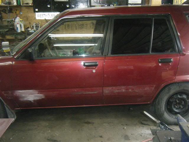

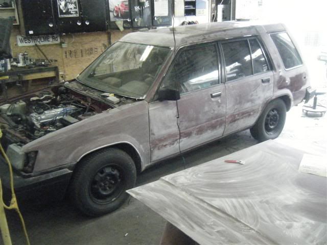

pre-paint

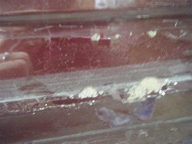

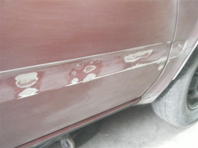

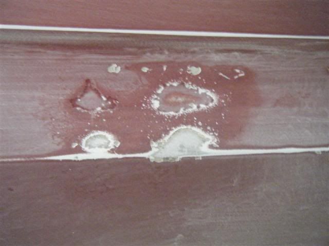

found the rub strips seemed to trap a lot of moisture and cause rusting. in this pic there are the big chips in the paint that came off with the rub strip glue but above them you can see the mottling and blistering of the paint where the rust was beginning to set in. the big chips weren't a concern because the textured surface of the chip guard would hide all of them.

you can see the encroaching rust in the usual areas here, which was the excuse i gave myself to paint the SOB.

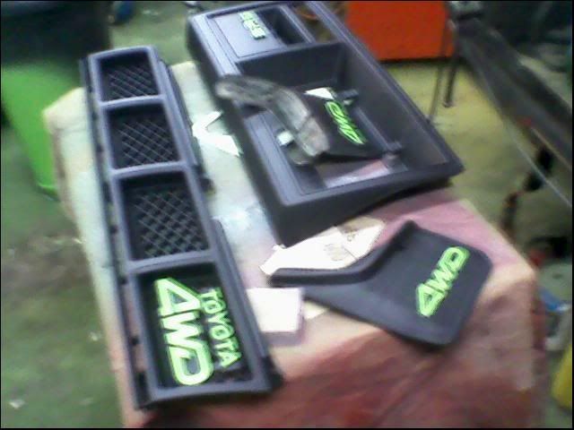

painted the trim pieces:

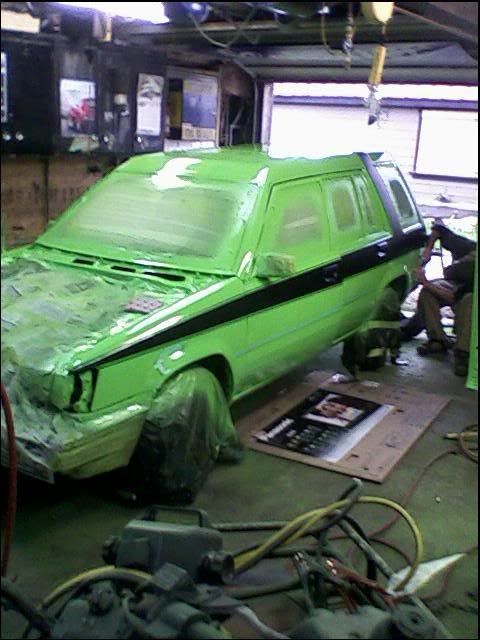

after 3rd coat, pre-chip guard:

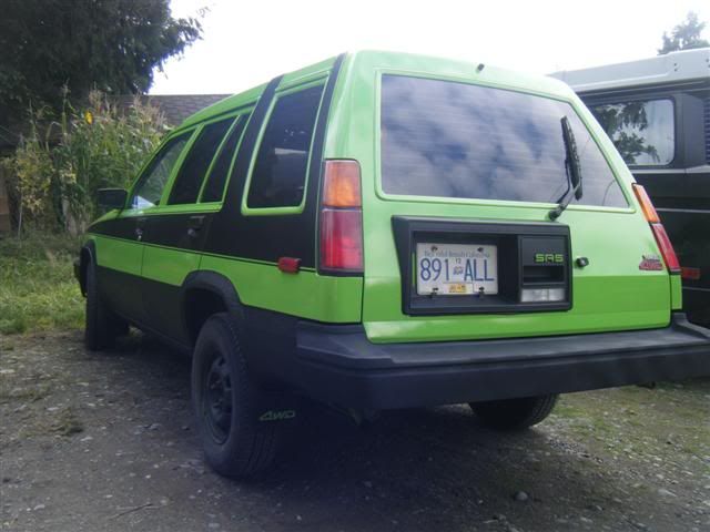

finished and back home:

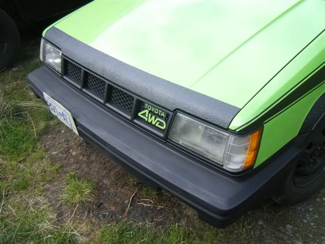

i had been looking into getting a hood deflector or even a car bra to protect the new paint but then i decided to just chip guard the hood as well as the lower portions. i really like the way it turned out.
there are a few areas that will need touching up once the paint has hardened in a month but overall i'm really happy with it.

What is "chip guard?" It sorta looks like the spray-on bed liner for pickups - true?

no, the worst rust was just in front of the rear wheel wells. you can see it in the 12th pic. definitely cancerous but nothing the chip guard can't stop for a few years.
you're right, chip guard is just some heavy duty stuff that is often used as bed liner for trucks. it's feels almost rubbery to the touch. we rolled it on with a swiss cheese-looking roller to give it a real textured appearance. lots of gravel roads around here and they take a toll on the lower panels. that's what made me go for it, besides looking truly burly.

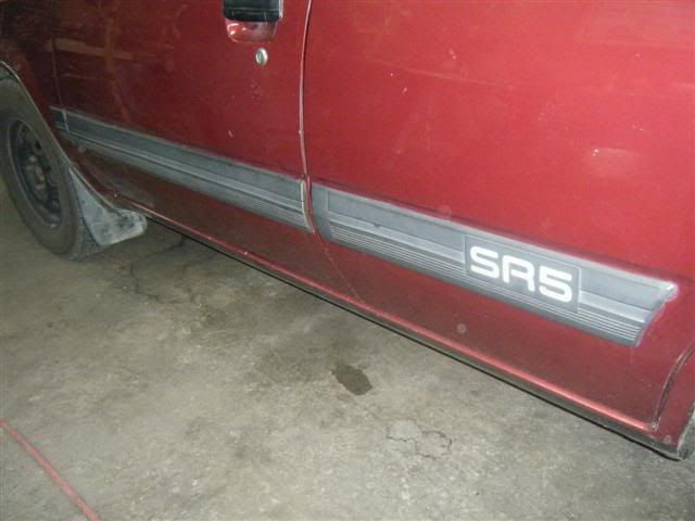

petros, i do have the door trim just in case. after finding the rust behind it i don't think i'll ever want them again but you're right, someone else might like them. luckily i drive pretty slowly so i should be okay with cops but you're right about that too: anything that stands out is a total heat score.
